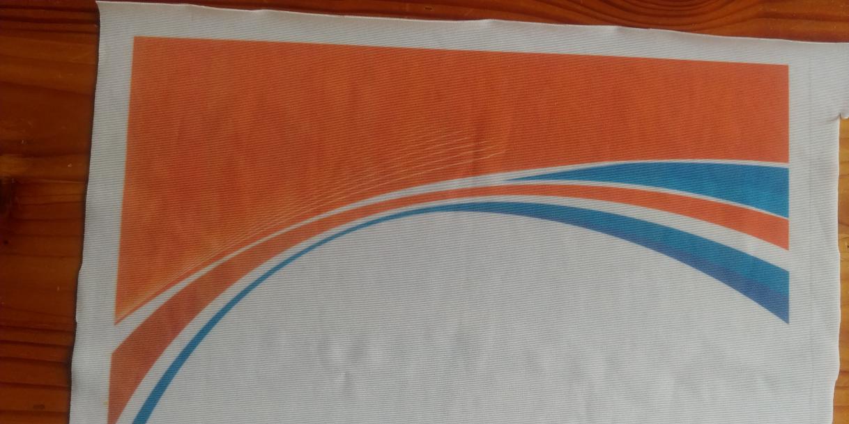

I have made a design in Photoshop and printed it with my Ricoh 3110DN. The print looks perfect. But when I press it on the fabric it does not come out as red as it is supposed to, but it comes out orange.
I printed something a few weeks ago and the skincolour also did not look right, it was too yellow.
I pressed for 1.30 minutes with a temperature of 188 degrees Celsius.

This is how it looks on the fabric:

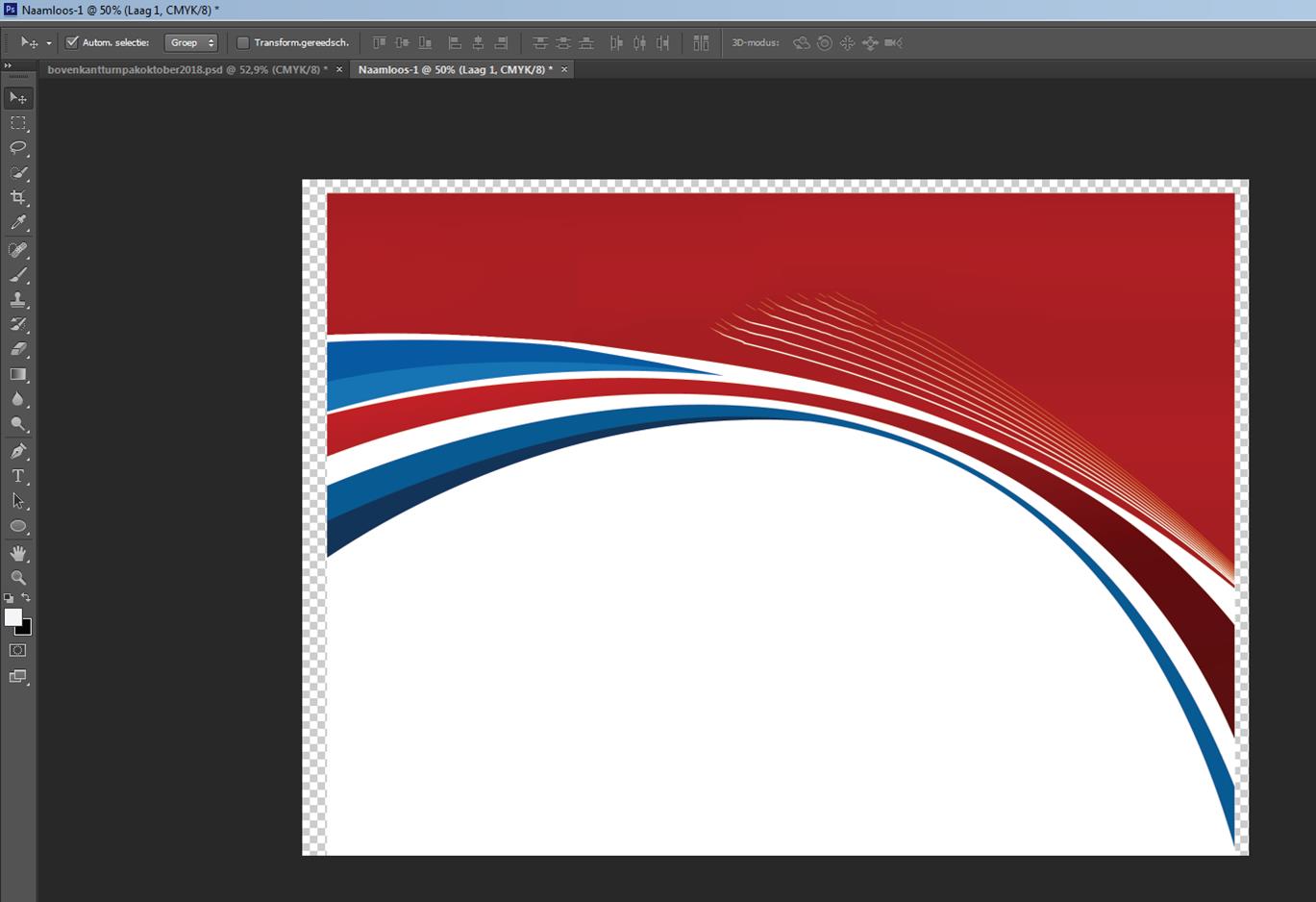

This is how it looked in Photoshop:

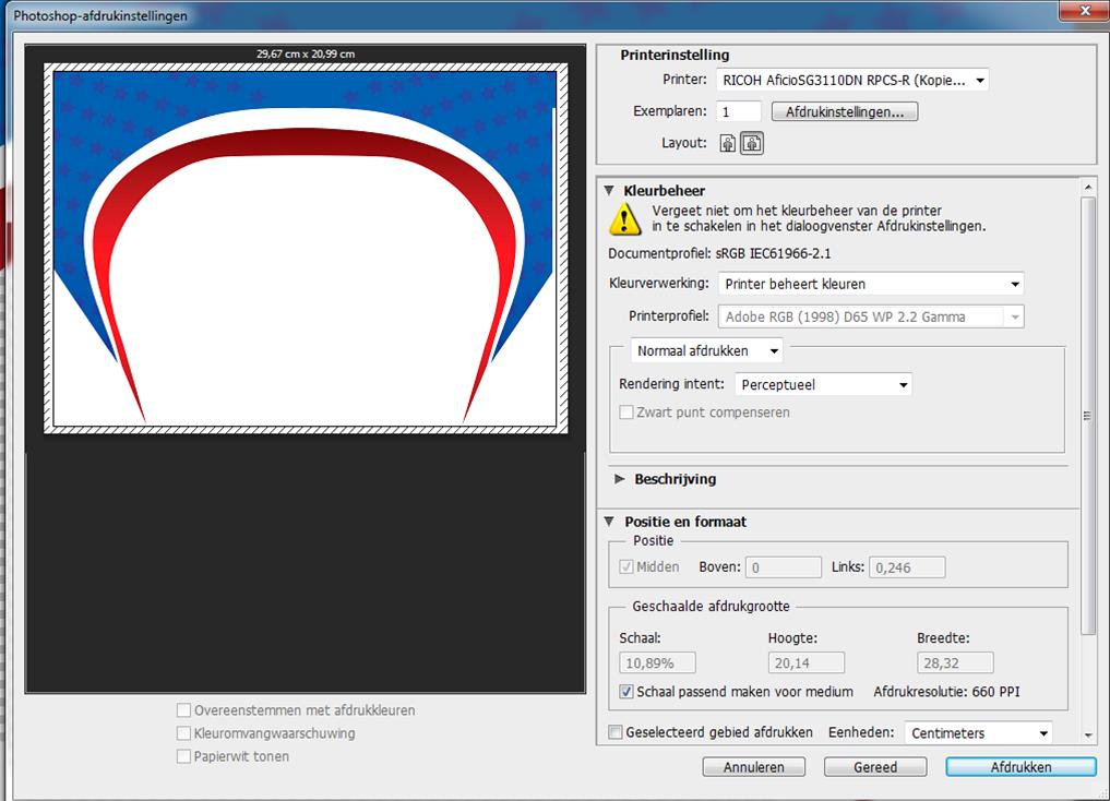

Hi, Can you post the page that comes up when you select "Print" in Photoshop

knightweb;134998 wrote:Hi, Can you post the page that comes up when you select "Print" in Photoshop

Hi, For Printer try selecting "Power Driver", I'm assuming that you have Power Driver from Sawgrass installed?

Re: Red is orange after press
'printer beheert kleuren translate' ............... does that mean 'printer manages colours?'
In Photoshop, it should be 'Photoshop manages colours.'

Yes that means that the printer manages the colours. I will change it and try again!
In the Sawgrass instructions it says that the printer has to manage the colours ...

Yes try Power Driver, that's what I use, ( I have Printer Manages Colors set)
