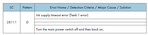

Here's the SC28111 error ...tagoz;136048 wrote:Webtrekker I thank you a lot, problem was switch J0254525 .. Although it is exactly the same switch as the top cover lid but of the switch even a seat behind the print head when the stand was in peace and to the switch hangs a lever to operate the switch. Lever had slipped out .. I have locked the lever, error is gone .. Now I have error code sc 28111, this is a printer. Although I have no guarantee but actually unpacked completely new.

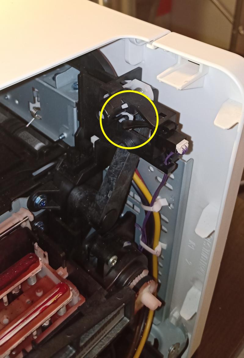

Had the same exact problem a couple of days ago. Solved by:
- accessing the printer from its left side (inks side) - you must remove two screws at the bottom of the left panel
- powering the printer on
- detaching the power cord while the print head was moving away from the inks side (thus having free access to its rear zone)
- bringing the black lever in front of the white plastic tab (the black lever had slipped behind it).
The attached image shows the correct position of the black lever.
