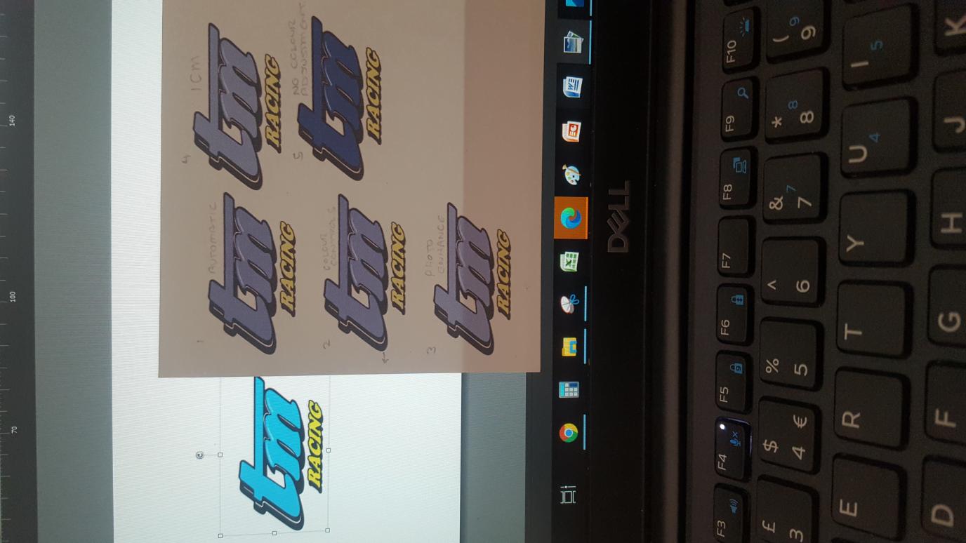

Having the same issue here where i am printing a blue logo and its come out as purple. Using ET-2650 printer, Ink Experts paper and ink, and mug press from MDP. 190deg for 180 sec and mug going in the press from cold/room temp. Im printing the logo from Photopad. The image on the screen is a nice bright vibrant shade of royal blue. But the first print came out onto the paper as purple. Knowing the colour on the paper doesn't mean it will end up exactly the same on the mug i gave it a try on an old unwanted mug, yep,,, came out purple.
So next, when i went to print, i chose Preferences - More Options - Colour correction (Custom) - Advanced - Then chose ICM under the colour correction options.
The printer then printed the image out blue, but not the same bright vibrant royal blue that is on the screen. It was a touch darker.
I printed onto a mug and its still a touch too dark compared to the image on the screen. Its not bad but its not perfect, i still want to get it right.
Ive not adjusted any of the colour sliders as i dont think i should be needing to play around with these settings each time i want to print something blue.

Ah Yeah, I thought I'd sorted it but then when printing out a light blue logo it went back to printing it out purple. I'll install the ICC profile when I get back home shortly. Using the girlfriends laptop at present which I don't believe currently has the ICC.
Re: Blue printing out purple - Tried everything I can think of :( ... New Epson ET-2711
It already has ICC profile installed. I'm still not getting it right though. The settings when I goto print, which I've tried are Colour correction AUTOMATIC. Then I've tried CUSTOM within which I've tried colour controls, photo enhanced, ICM and No colour adjustment. The colour still comes out purple in most cases as you can hopefully see from the attached photo. I'm sure it's something simple I'm doing wrong. I'm still trawling through old posts on here as well as I know I'm not the only one who has faced this. I thought I'd solved it earlier but I'm going to keep trying.[ATTACH=CONFIG]6394[/ATTACH]
