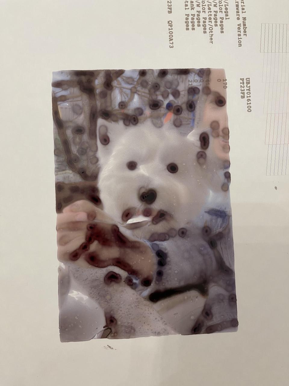

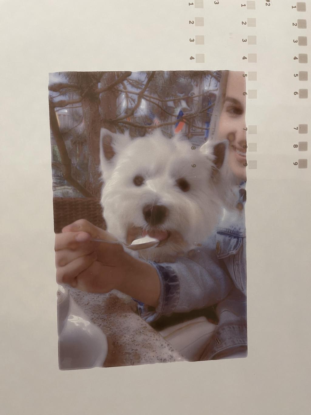

I decided to start little phone case business so I am new to sublimation and already facing some printing problem.
I get very poor quality printing with EPSON L1800 on transfer film, it looks like too much ink is putted on film or image is not sharp enough with borders. Maybe anyone could help me or had same problem?

I did everything as advised from sunfly, but just can't get correct quality. I already made many tests with different settings but nothing has worked. Maybe it's the ink or the film?

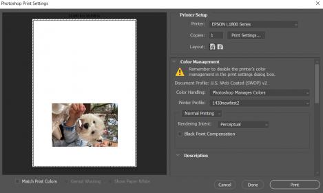

Do you have a specific profile for that printer and film combination?

Yes I have specific profile, for their ink film and my epson printer. They say it's the settings problem, but i can't solve this.

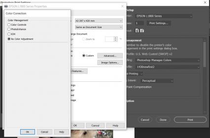

What settings do you have, paper etc?

sunfly adivised to use photo quality ink jet, but on this it put very much ink on film, it's better with plain paper but still very bad quality.

Have you tried matte? Use RGB not CMYK.

I have tryed in matte but in cmyk, on matte it puts much ink aswell. I will try matte in RGB. Yes I am sure I am printing on coated side, not on shiny:)

This usually happens when profile isn't right or paper selection is wrong.
