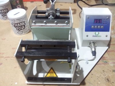

We are using a Ricoh printer and here is the press....
[ATTACH=CONFIG]1250[/ATTACH]

vB_ID:1250
vB_ID:1250
mug press.jpg (76.19 KiB) Viewed 288 times
