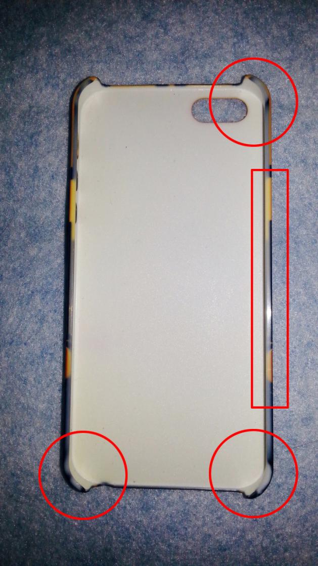

I got my machine. Printing seems to be really good, but I am having problem printing the corners (pic attached). Can you help me with this problem. The back side walls of the case (rather I should say front sides when we put the phone in) are not printing fine. I have tried every option I could but still same result.[ATTACH=CONFIG]2340[/ATTACH]

Hi Nishu, perhaps try to press the silicon on the back side walls of the case after you start vacuuming? It will make sure the paper gets in contact with the case and pressed properly thoughout.
