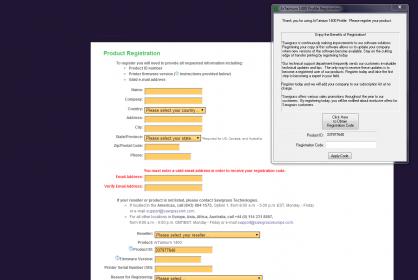

hi david, thanks for taking the time to help unfortunately trying to drop the profile in to c:\windows\SysWOW64\spool\drivers\color\ did not work and right clicking did not work if I remember right when I was on xp and vista you right click install profile and when you click on profile if the profile has installed it then says uninstall also when I tried the green icon profile you sent all I can get is the same as the message I got when I tried to download from sawgrass I have attached the form they want filled in unfortunately I had a stroke last year and my memory is shot so I can't remember the way to get the info I need to install the profile

you could try an earlier version of the installer from here and see if it works on your system, it doesn't ask for registration (scroll down the lower right of the web page to find it). can't understand why the icc profile won't paste into the color drawer have you tried putting them into "c:\windows\System32\spool\drivers\color\" as well? You could try this: On Windows 7, go to the Windows Control panel > Color management > All Profiles > Add
