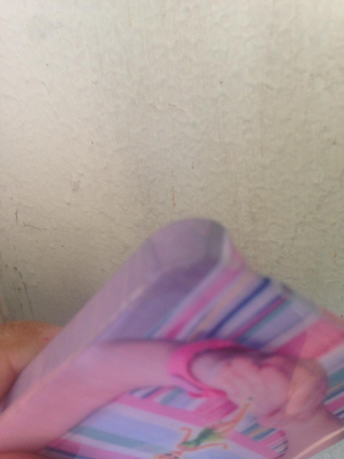

Tried to make some iPhone cases according to the manual by ArtyGamer but did not manage to get the corners that good. Corners are pretty ok when I use film though. But there is also a problem with the front edges, please check the image.
[ATTACH=CONFIG]2792[/ATTACH]

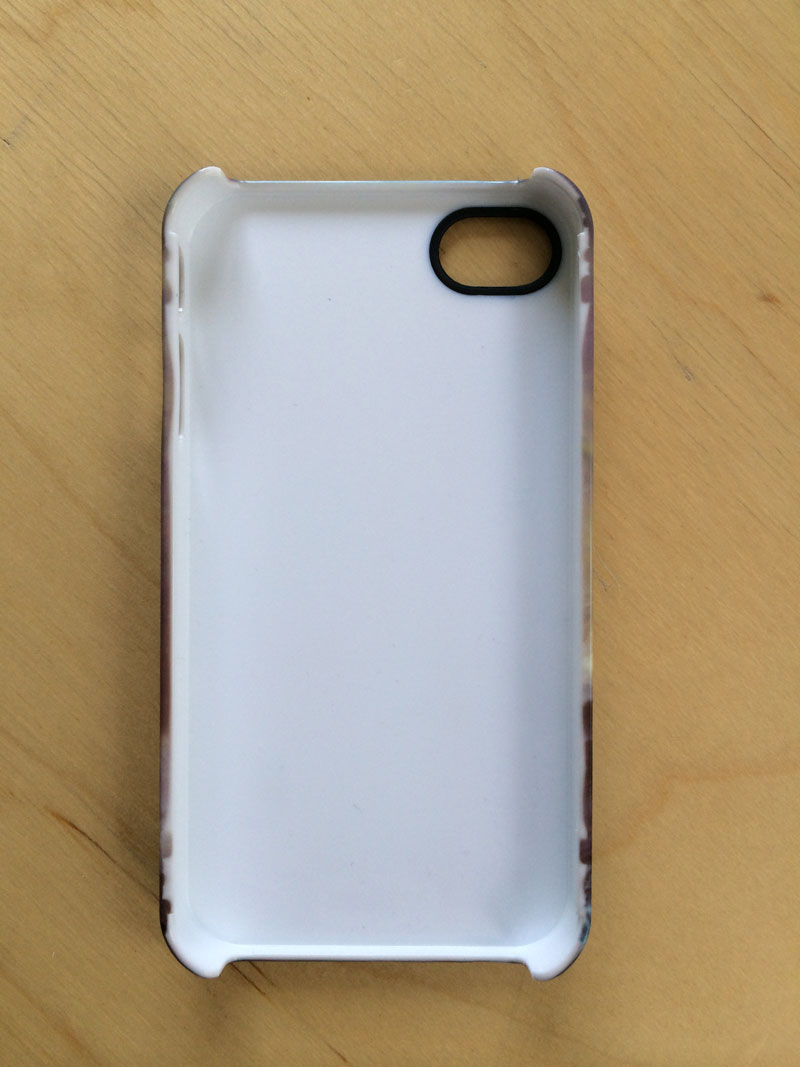

Re: Trying to find a solution for iphone blanks corners... We can do it! :-)
socialgiraffe thanks, that's what I have been doing but when the vacuum pulls down the corners don't seem to pull in tight enough even with prodding and poking its almost like the paper is too thick and stiff or maybe there is not enough vacuum. Could you post a close up picture of one of your corner's, not the finished case but when the vacuum has been applied and you have smoothed it please.
[ATTACH=CONFIG]2864[/ATTACH]
Its a terrible picture, but it gives you the idea.
