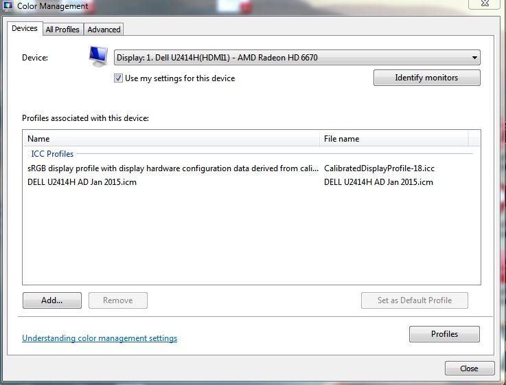

I think Paul has explained it pretty well. First port of call is to get the monitor profile and instal it into widows assuming its not here already.
Goto control panel
Display
adjust resolution
advanced settings
Colour management tab
Colour management
That will show you you monitors profiles if any
vB_ID:3197
vB_ID:3197
monitor profile.JPG (58.87 KiB) Viewed 211 times
hopefully you can see the attachement showing my profile from the Xrite which automatically gets saved there but a downloaded prifile can be saved there just as easily I use the bottom one generally not the SRGB one(I've renamed it)
