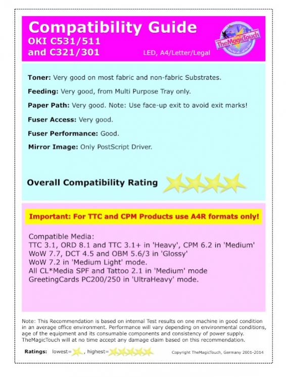

just found a Compatibility chart on the TMT .com site but cannot seem to post it from my iPad. Will post it when I'm on my iMac
Kath G

Here is the compatibility chart for TMT for our printers
Kath G

Just thinking, it's a bit strange when their compatibility charts says it works with the OKI 321......oh well their loss
Kath G
