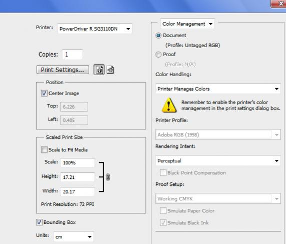

Just had another mess and I can get the end settings the same....

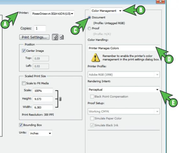

@Justin, to answer the "same settings" , no mate there's a drop down box missing on V3.6 that V4 has....
