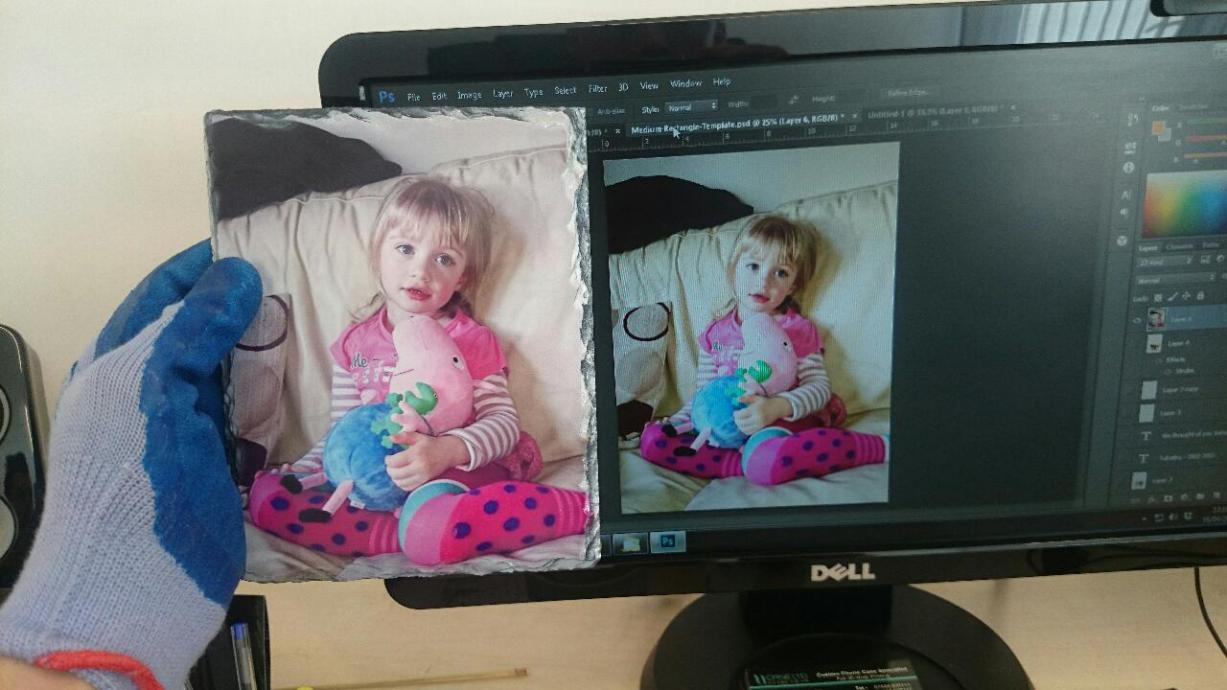

Thanks for suggestion. When I convert Pantone 021 to RGB it's: 254,80,0 which shows as "out of gamut".
I just printed and produced a photo slate to compare it to one I made a few months ago (picture of my daughter for my wife).
The product match is spot-on and the on-screen match is pretty good too.
vB_ID:3394
vB_ID:3394
Although there is no real orange in this picture I would have thought if it were printer problems then some colours would be off, especially the pink.
I Also thought it might be my ink as it must be close to exp' date (no I didn't check the date when I put it in) but on the head test all 4 colours printed just fine.
There is also a similar colour on the trim of the glove in above image - which is also spot on to actual glove.
