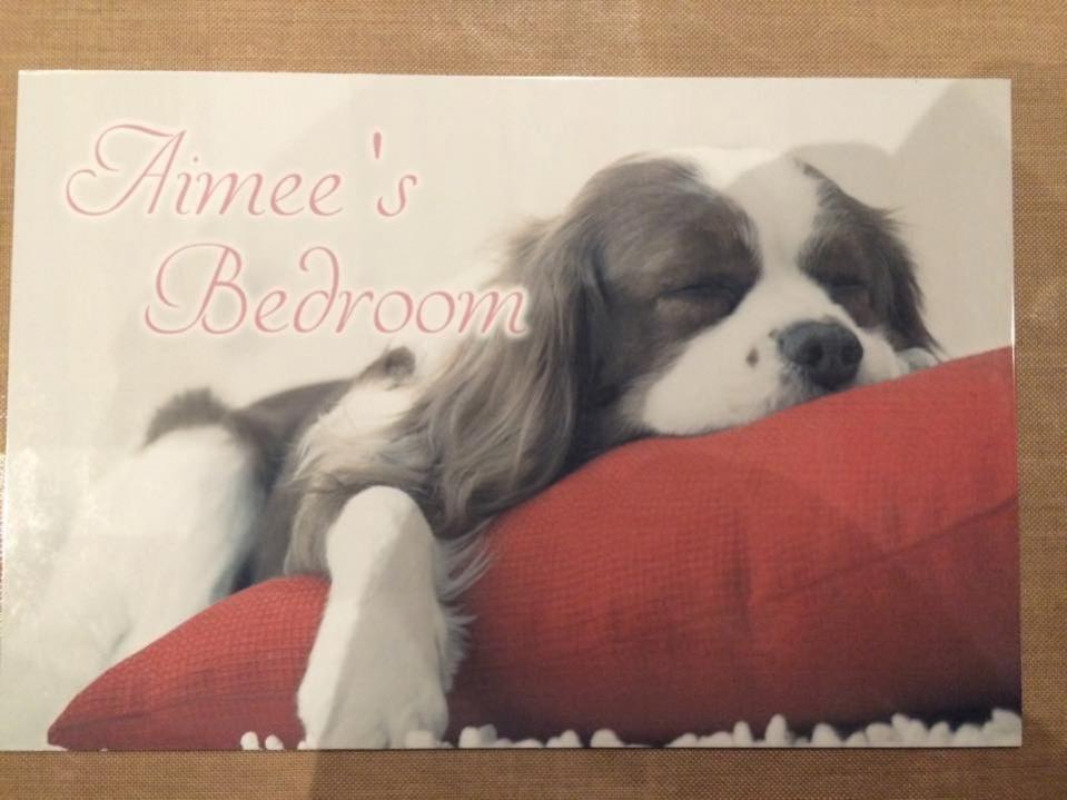

This is with powerdriver
vB_ID:3639
vB_ID:3639

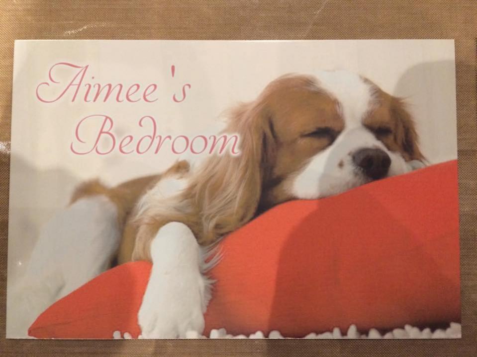

This is with standard settings (set to high)
First image with powerdriver has the detail (in cushion for example) the basic has colour in dog but detail is poor
Pressed onto metal which I have had good results with before using a cheap epson printer
The brick wall my head is banging against is starting to crumble :(

If your inks aren't Sublijet-R or VisiSub then Powerdriver isn't going to work. You need a profile for whichever inks and paper you're using.

Thanks Scotty
I only tried the power driver as I have (I think tried everything else)
What baffles me is the company i have purchased from have tested with same printer, profile, inks and paper but the finished results are very different
