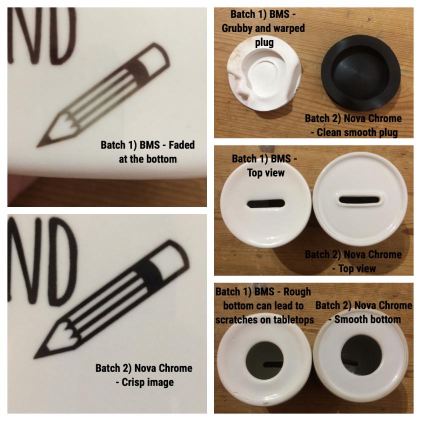

The results are in!
Had a quick test with the Nova Chrome batch last night and goodness me what a difference!
They came boxed individually which is always a bonus but this may just be because I got a sample set of 12 so I'm not sure if they are boxed individually on a full case of 36.
Pic below to compare the two batches I've had. On the left side the BMS ones and on the right side the Nova Chrome ones.
Both done in Freesub ST-210 double mug press at 170C for 140 secs.
Hope this is helpful for anyone else looking to do money boxes.
Please forgive image quality - not the best on my phone but gives a good comparison!
vB_ID:5112
vB_ID:5112
Money Box Review.jpg (82.58 KiB) Viewed 441 times

The normal 36 also come individually boxed ( or did last time I bought them)
If you are worried about the bottom of the money box do what I did. Pop down to Wilko's and buy a roll of table protector tabs. I think 100 costs about £1.95. you need 3 per money box.
always looks nice to customers if you have them on.
