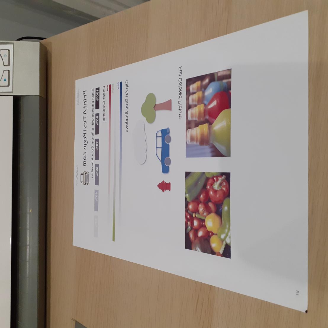

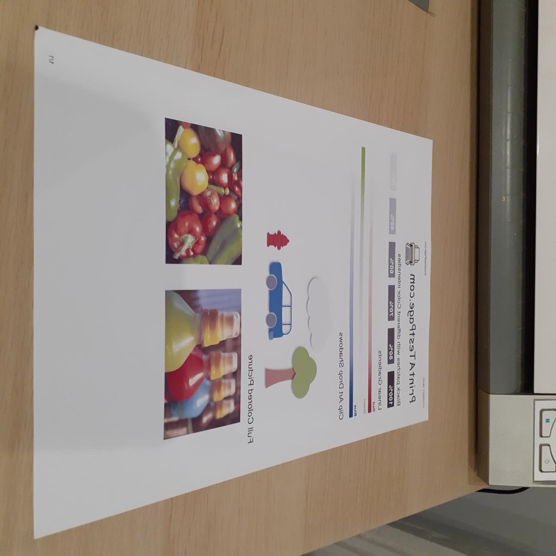

Thanks for the link to the test pages. Puzzles me even more as all are coming out fine. [ATTACH=CONFIG]6794[/ATTACH] At least it looks like it to me. Any comments?

Thanks for the link to the test pages. Puzzles me even more as all are coming out fine. At least to me. Any comments?

Just make some block of colour (cyan, magenta, yellow, black, red, green, blue) in photoshop. They don't have to be accurate to the printer, just do 100% of each in PS.
This should show up where the problem is in away the nozzle check may not.
I would however, for future, see if there's a way of using ICC profiles in Photoshop rather than the PowerDriver managing the print colours.

Have you changed the image to 16bit by accident maybe or something like that?
you could always email the image but I suspect it’s your settings somewhere as the test pages are printing spot on.
