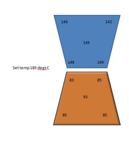

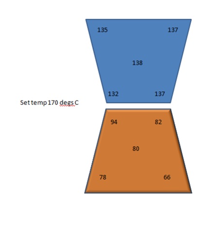

I have done a temp check, and i am thinking the heating element is not the same as the reading on the screen.
PW66 - i did up the temp and here's the results.... again, not sure what i am expecting the variance to be between the temp on the plate and temp reading on the display.
[ATTACH=CONFIG]7428[/ATTACH][ATTACH=CONFIG]7427[/ATTACH][ATTACH=CONFIG]7429[/ATTACH]
I suppose if the element is on the way out i will need to go off the gun temperature and not the digital display, so for hotflex, set the machine to 195 maybe and check the plate with a gun until i am getting 160 degrees C.

That is all you can do. There is obviously a mismatch between the thermostat and the element somewhere - it could be the element failing or just a faulty thermostat.
Have you checked that all of the terminals inside the plug or even in the wall socket are screwed in tight? (turn the power off first!) I had a similar problem with a screen printing flash dryer not heating up properly some years ago. It turned out that there was a slightly lose connection in the wall socket. Try using a different socket and see if that makes a difference.
