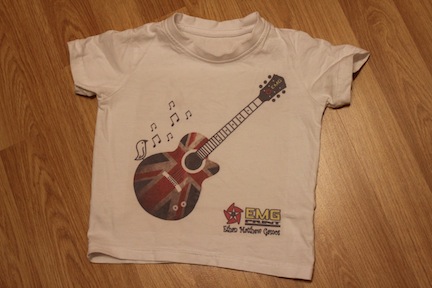

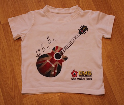

hi there, have tried printing shirt using Yolo jet-pro soft stretch as they said JPSS is one of the best paper in cotton printing, but was disappointed with the result.
Before washing[ATTACH=CONFIG]1037[/ATTACH] after washing[ATTACH=CONFIG]1038[/ATTACH] :eek::confused::eek:

mrs maggot
Posts: 3452
Joined: 17 Dec 2009, 05:00
Re: Durable Printing
Post by mrs maggot »
how did you wash ?? they need a really cool wash and inside out for best results oh and good ink to start with
