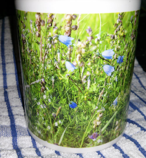

Just tried a mug as suggested, monitored the temperature and it went up to 205C.... Let the timer finish and the result was ok but overcooked. I did wait to set the timer when temp reached about 120C to allow for preheat.
Next one went in for 15 minutes with no preheat, temperature between 180C & 200C. This one came out well (in my limited experience...) so will try more over the weekend. Room temp at 26C so not much fun slaving over the hot stove.
[ATTACH=CONFIG]2873[/ATTACH]
