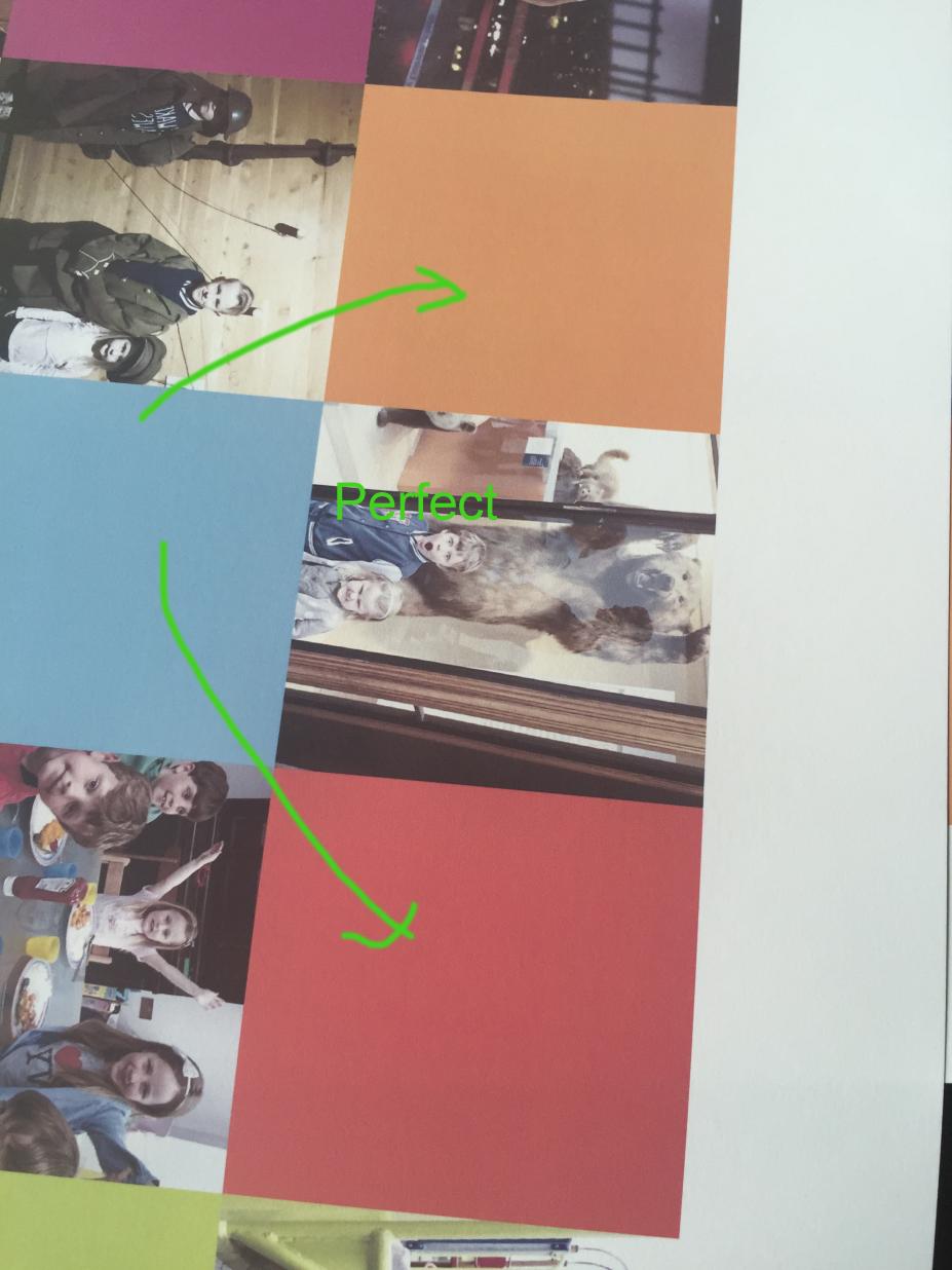

Hi, i've managed to get the image looking great it most areas on the new printer by tweaking the paper feed adjustment manually on the printer instead of printer options but since taking this brand new printer out the box i've been getting these horrible smudged looking vertical lines along one side of the page and its the same side every time. You can notice it on the lighter colours. Just as i get one problem solved another takes over. Any ideas what causes this? Its only on one side of the image and its on every print, no matter what i print. Anyone see anything like this before?

I have just flipped the image round 180 degress and printed it out to see if the problem still occurs. This time the area in the previous attached photos printed out without the blurred lines but the opposite side has them now so its seems something on the front left side of the printer is causing this to happen.
