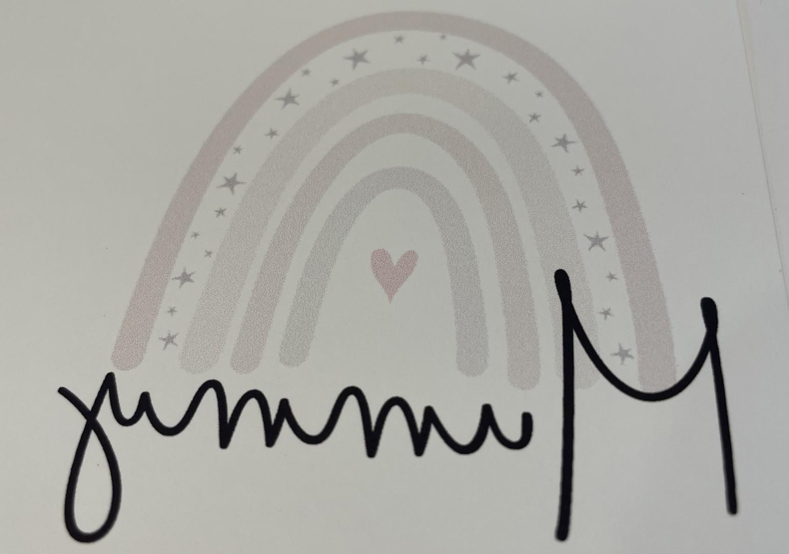

Yes, I have an update and unfortunately the situation is still ongoing. EPSON have closed the case as their level two team believes after their own testing that my unit is working within specification.
Below is an image from their test results:
[ATTACH=CONFIG]6711[/ATTACH]
The visible dots on the printout are still visible after transfer onto a mug which for us is completely unacceptable. I am still trying to get the reseller to accept the F100 back.
My experience is that the F100 is worse than the cheap EcoTank I started with.
There are others out there with the same issues, someone messaged me on Facebook asking if I had found a fix as they have the same problems, and one other person I have spoken to returned theirs due to the same issues.
