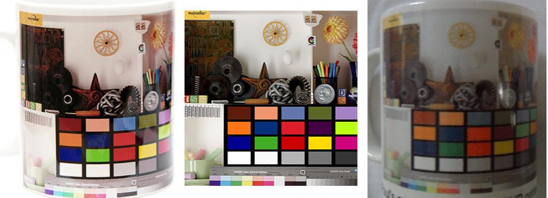

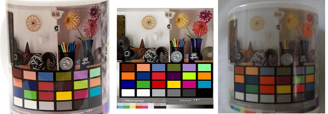

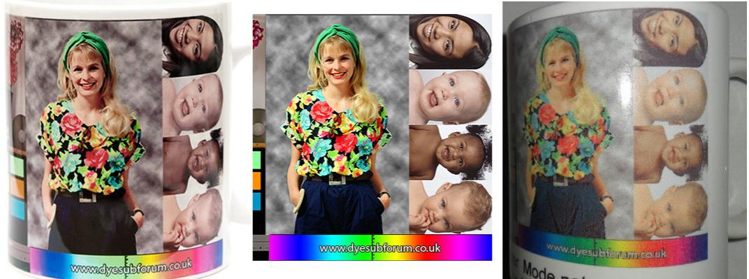

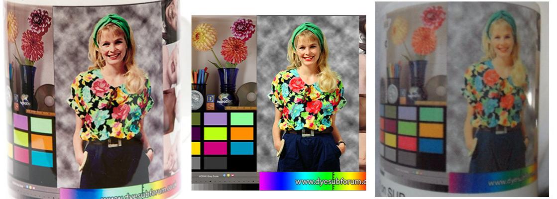

Here's an example of how mine prints so you can see the crease and the pants colour.[ATTACH=CONFIG]2126[/ATTACH][ATTACH=CONFIG]2127[/ATTACH][ATTACH=CONFIG]2128[/ATTACH][ATTACH=CONFIG]2129[/ATTACH]Just ran this off on my S21...P50 and B1100 PaulP50 and B1100 are matched as they have been profiled recently. Thing that strikes me is the ladies trousers have come out very dark blue almost black on all of my prints. Just wondering how this compared to everyone else's test print?
I get none of the crease detail in the trousers at all.
This is what I get when I print it. Paul's mug is on the lsft, the relevant piece cropped from the chart is in the middle, and my mug is on the right.
This is interesting for me because I am printing without any ICC profile. You can see the colours are all wrong. The brown is too light, the reds are a little too orange and the yellows are, well yellow/gold is too yellow.. And my greys are coming out too grey! My blacks are also a bit too black.
On the other hand, the dye sub prints almost exactly match what I get when I print on my Pigment printer on plain paper. So instead of proofing on the screen, I should be able to proof on my printer, by adjusting an image to what I think might fix these colours, and printing on the pigment printer.
Once I have that looking right, all I need to do is save a preset to fine tune in future - I hope
Being able to compare to a mug by someone that is using a profile gives me some idea what I need to tweak. If I can reduce the orange tint in my reds and deepen the browns I'll be happier.
Thank you Paul for providing an example mug for us to check against.
