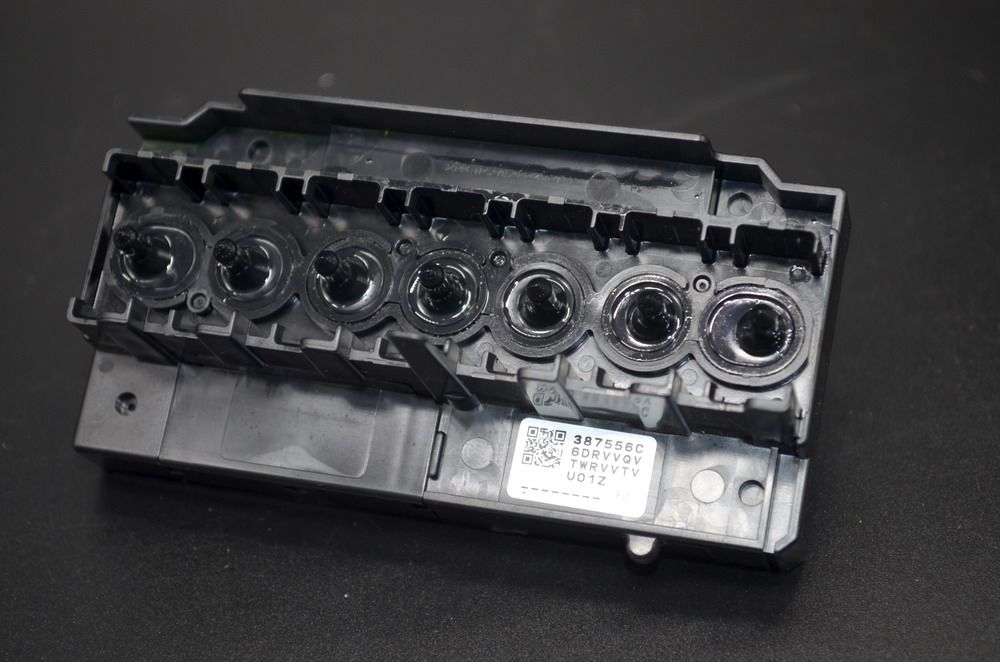

Got it back hadn't reset the dampers properly. Didn't push them on properly to busy rushing and getting worked up. Had a cup of tea and rechecked everything. But we are back to the clear checks on every line bar the cyan. Now I know this is not the technical terminology or even close but could it be the nozzle bits that the dampers fit onto. Is there a way of clearing them or is that what a pwr clean does anyway. I will get a photo of what I mean and the most recent nozzle check.

Have found my own answer. I know reaslise that is actually the rear of the head unit. So I am guessing I cant do anything there then.
