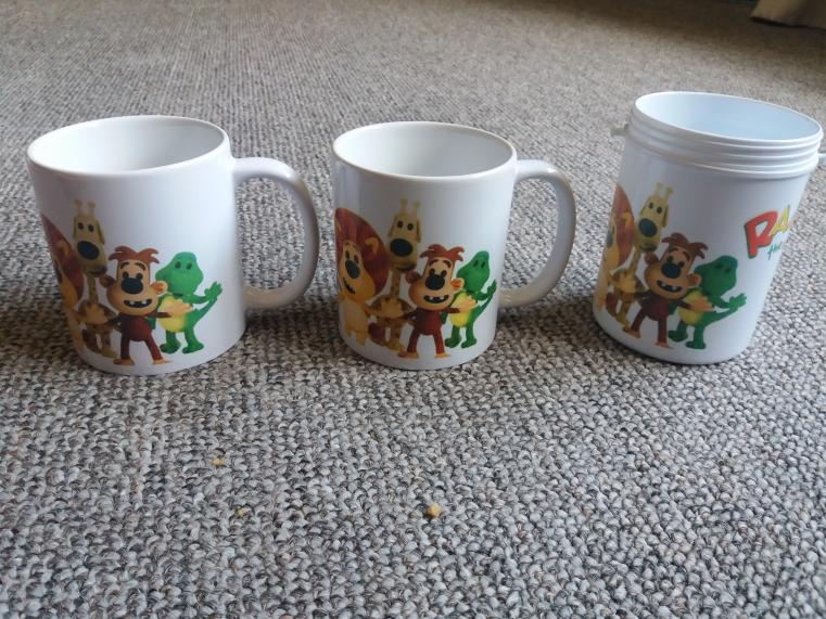

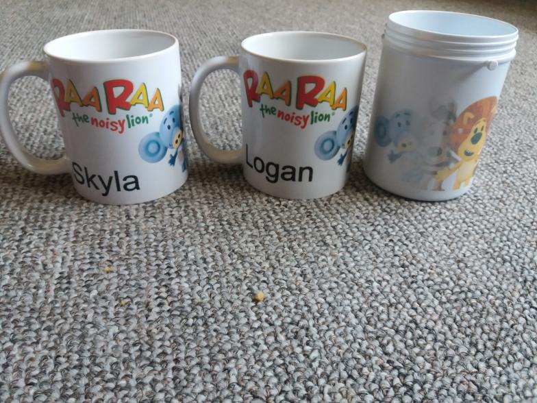

So had my 3d machine about a week and had a play last night.
first mug 6 minutes and second mug 7 minutes which looks better IMO?

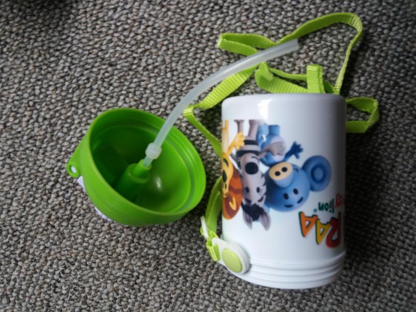

The kids plastic bottle is not working the way it should. Im thinking maybe i need a mug press for these and they cant be done in the 3d vac machine with the mug clamps?
Any information if this is he case and opinions on the mugs :cool:

6 minute mug on the left.

The colour on the Logan mug looks better IMO. Colours are a bit deeper.
I was thinking about buying a 3D vacuum instead of another mug press, but for what we do, I think having a couple of mug presses running would be better.

I might give it one more go with a cup maybe leave it cooking for 8-9 minutes and if still crap get a cheapish mug press just for the bottles.

Not bad at all for a first go with a 3d machine mate. What size is the plastic bottle?

They are 400ml mate. Now a couple of uk sites what sell them say 80/120 seconds. Temp 175/190 and medium pressure light/medium
Now obviously using the big 3d machine its hard to gauge it. One chinese site does mention the 3d can be used.

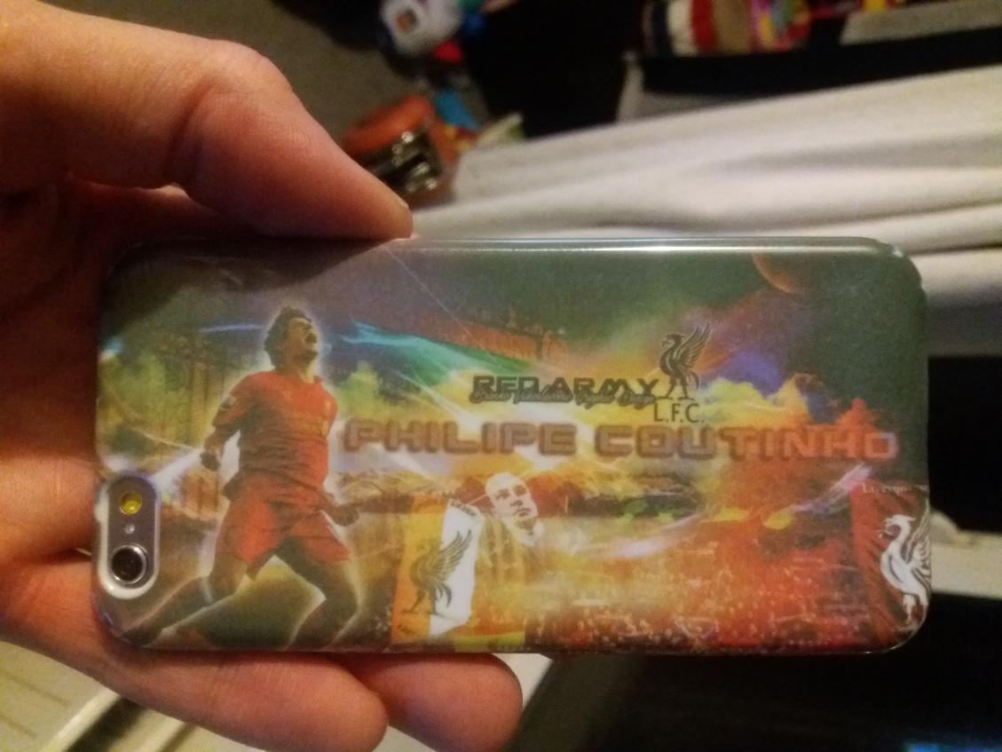

So after my first mugs turned out ok i tried a iphone case tonight. Not what i was hoping for!

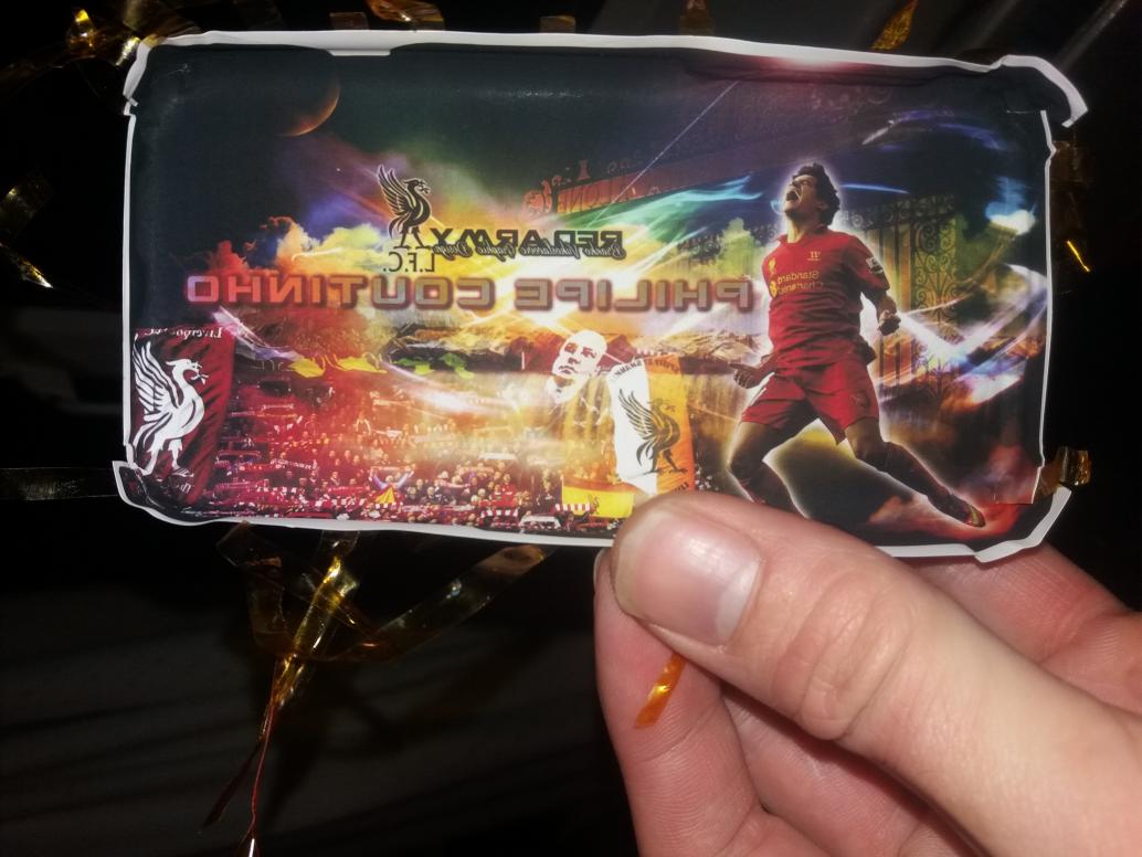

Quite a lot of ink left on the paper.
Cooked for 9 minutes set at 193 degrees?

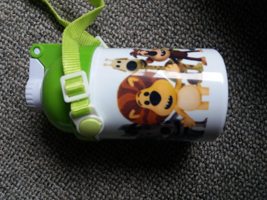

So i didnt drinking enough coffee or beer and search the forums hence why that cover came out like that.
But got the kids bottles sorted now!
Only annoying thing is the heat tape marks. Maybe cook for a little less time.
