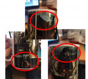

Hi all.
So I did my first mug this weekend and I am not pleased with the result. Dark areas on the image came out very dark on the mug. I am using a epson 1500w with ciss from cityinkexpress, as well as a profile provided by them. I had to use their brand sub paper as well, as they didn't provide a profile for Jetstream paper which I also have. I am pressing with the double mug press from freesub. Did a couple of tests with different times/temperature. Result were slightly better with less time, a total of 200 seconds including the time from idle temp to 180 degrees. I'll add a couple of images with some details outlined to see if anyone have any suggestions. As you can see prior to printing the areas are dark but still alot of details, on the mug those details are just dark.
vB_ID:4835
vB_ID:4835
test mug1.jpg (14.95 KiB) Viewed 490 times
vB_ID:4835
vB_ID:4835

One more thing. Cityinkexpress provided ICC profiles for epson 1500w and the following papers:
Anne Paper
Cityinkexpress paper
Dino Dyesub Paper
Monarch Paper
Signzworld Paper
SubliPlus Paper
SubliSharp Paper
Subright Paper
TruePix Paper
XPres Paper
I currently only have Jetstream and the paper from cityinkexpress, which by the look and feel of the paper seem like a poor quality compared to Jetstream. As Jetstream is not on this list, can I choose one of the other papers? Is anyone of them close to jetstream?

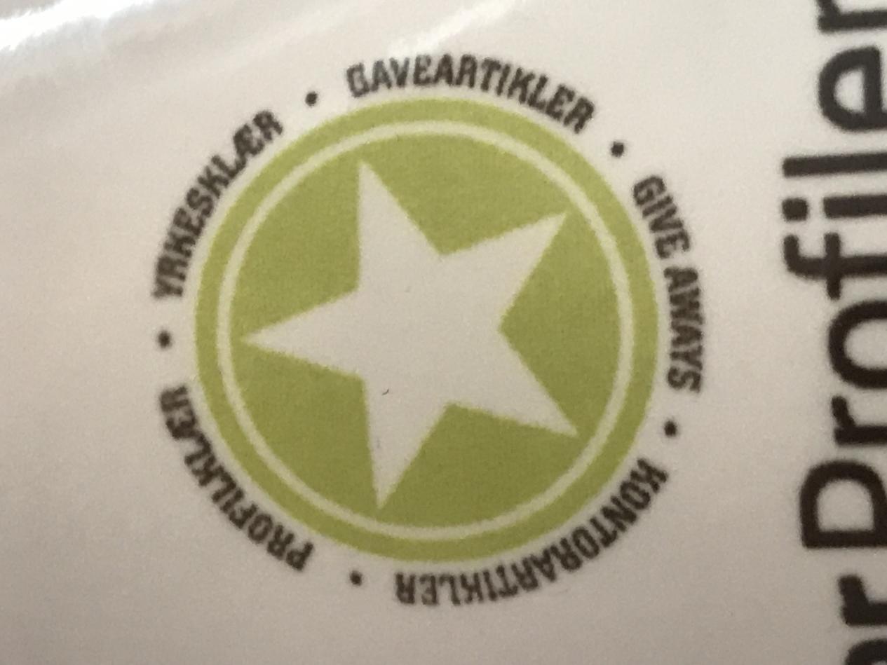

I think I might just go with the Ricoh and sublisplash, but it's really annoying that I can't get this Epson 1500w + CIE inks to work at all for me! On paper the colors are very "grainy", and they still are when i print them on my mugs. Should I not be able to get 100% solid colors and sharper text/photo with this setup? The color profile seem okay though, but it's the unsharp and grainy result that really brings me down.
