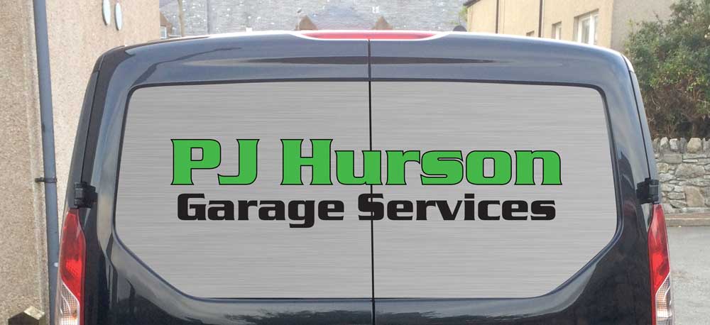

This the graphic I'm proposing, it will be a single piece print and cut (laminated) so as mentioned above I guess just slitting down the middle and wrapping slightly over the clean edges will suffice.
I tried adjusting text etc. but nothing is working for me.

Don't rely on the outlines for the panel size. I would do a paper template of the rear panel. Print the whole image as a rectangle and then use the template to cut to shape. Alternatively if you have wrapcut or similar you could use that.
https://signtradesupplies.co.uk/applica ... -tape.html

Yes, that was the intention, this is just to show to the customer :-)
Never seen that stuff, looks very useful thanks.
