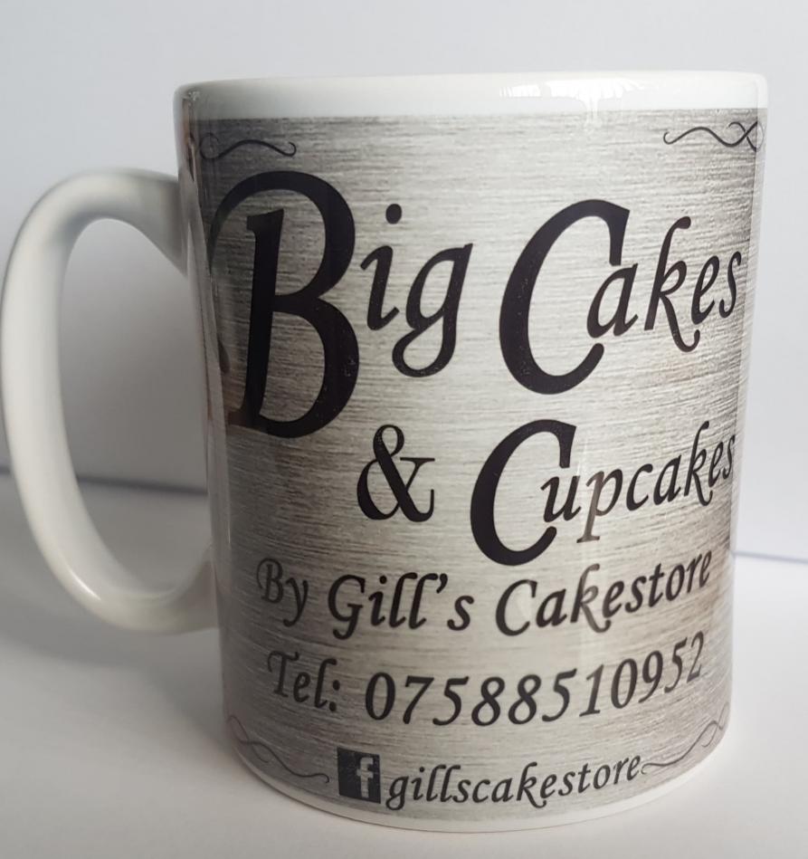

Mach-One
Posts: 20
Joined: 20 Sep 2018, 20:18
Re: Freesub ST-210 double mug press advice needed please
Post by Mach-One »
vB_ID:5404
vB_ID:5404
First print with new carts and printer 170c 170c
This is my fourth actual mug print since starting
