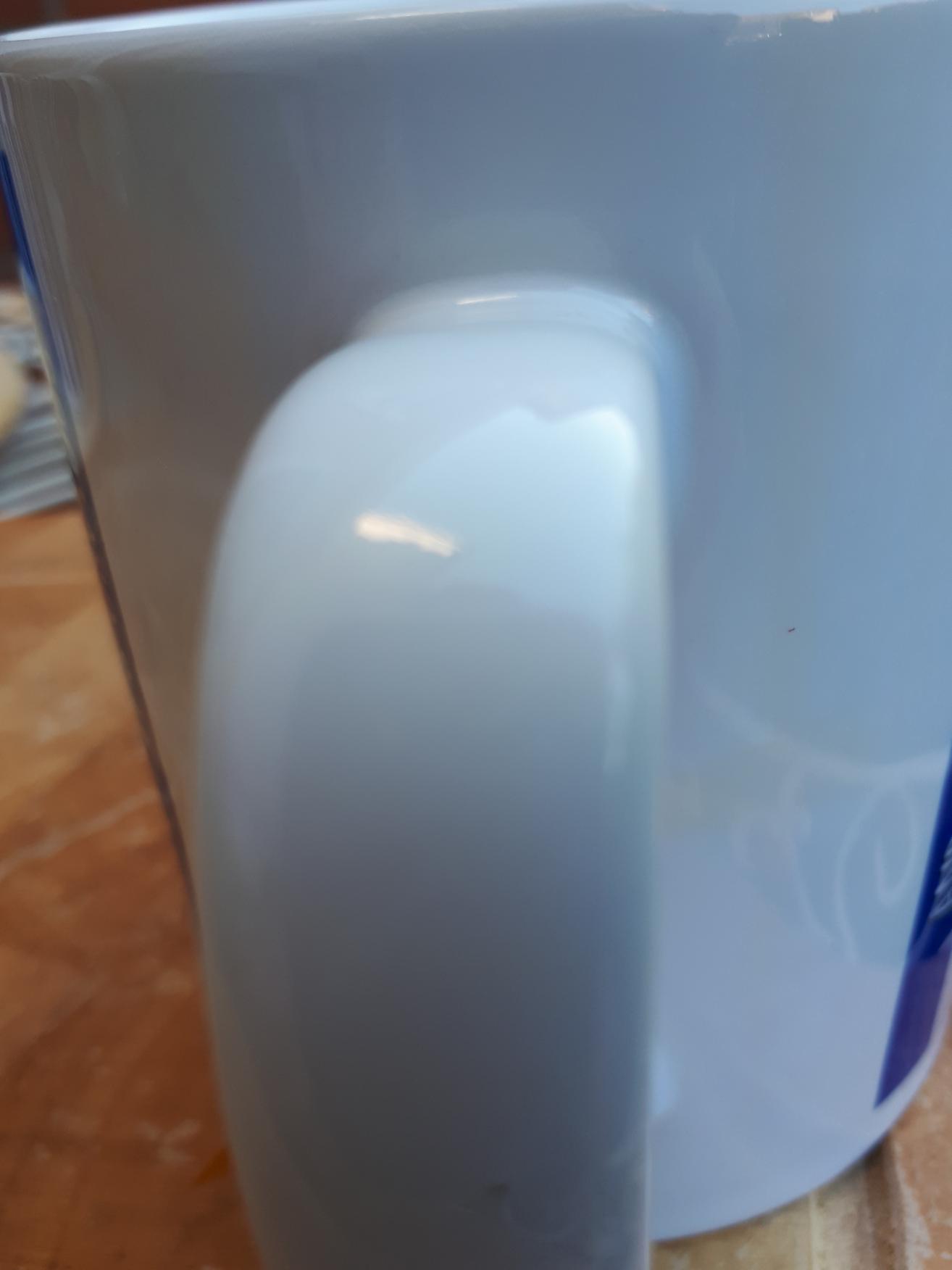

i'm printing mugs in halogen oven and I'm liking the print quality especially near the handles but I've noticed I'm getting yellow marks where the heat transfer paper sits and a vertical stripe where the edge of the paper lies. I'm using the sub paper plus a couple of sheets of copier paper to protect the wrap. Has anyone had similar and know how to prevent.

I used to have this problem - I think it's just rogue ink gas in the oven. Solved it by cutting the paper slightly longer and 'breaking' it over the handles as shown below so the full mug is covered. I also find I have to let the paper go a bit yellow with heat to get full transfer without any faded patches. Not a problem unless it goes really brown!

thanks for your help, cutting the paper to shape looks like a real faff, preparation is already taking 3 times longer than the heat press, (placing transfer, placing protection and placing wrap) but I think it would solve it.
I've gone down 12degrees and the problem isn't as bad, just where the heat tape sits now. I'm wondering about the heat tape, if it is poor quality, I bought it off ebay, do you get much better quality tape when you buy from the sublimation shops or is it the same stuff?

I cut my sub paper into 3 sheets and the tape has always been fine in the heat press, i suppose it's much cooler near the handle so its not been a problem although it should e good to very high temps. The marks are definitely from the tape as they are the same shape in the same place and yellow-ish like the tape, it is not residue i've tried to get the marks off with acetone and they don't budge. I don't think my oven has much residue ink as its quite new and all my prints have been well sealed with the extra paper and wrap and the marks are where the tape is rather than around it. I'll try printing 2 per sheet instead as suggested. Thanks again for the help.
