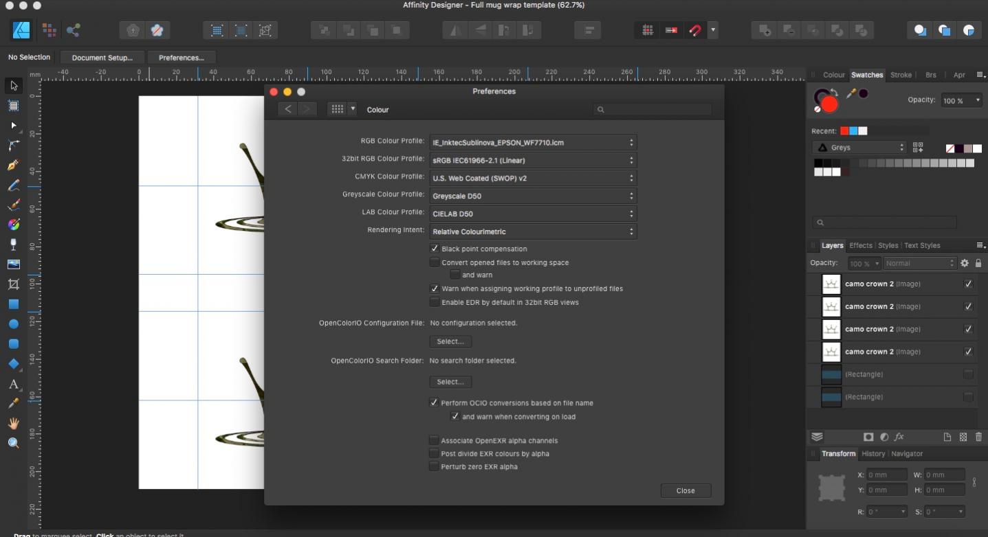

Only thing I cant get right is the logo / image to be in the same place on the mugs ha ha, I made a template on Affinity designer, saved the file as a PDF and opened it up in PS to print the artwork but cant seem to work out why each image on the both sides are in different places.

webtrekker;139046 wrote:Can you not print directly from Affinity Designer? I thought it accepted ICC printer profiles.
No sadly not, well if you can I cant seem to do it ha ha, I did try and the print just came out B/W, same as the cameo 3 print & cut, I cant get the ICC profile to work with that either:rolleyes:

Affinity Designer is fully ICC compliant. There is a colour options tab whe you select print. You can select your ICC profile there and set the app to handle colours.

Ive got the profile linked & setup in Affinity, I just cant get the printer to print it in colour like it should be :( maybe Ive checked the wrong boxes?

Affinity screen shot 1 - 1.jpg (86.88 KiB) Viewed 339 times

That is in the preferences. You set up out put colour when you select print, under the colour tab.
In preferences you should set up your RGB space as the 1966-2.1 profile. IOf you set it as a sublimation profile all you are doing is proofing the monitor to show the colour your tranfer will print, not the colour you want to sublimate to.
