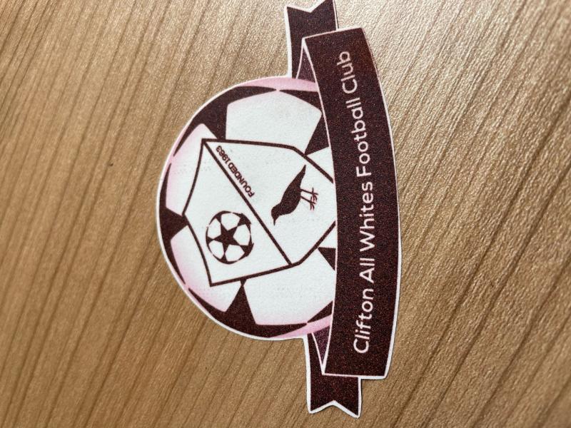

I'm attempting to use siser easysubli htv but getting an issue with it turning pink on the edges, I have attached tow images, of of the image I'm using and the other the the printing image.
I'm wondering how I stop this occurring.
I'm using a MacBook Pro, Silhouette Studio using Colour Sync Epson IJ Printer 07 in the print options and an Epson ET14000.
Also as a side note, if I were to outsource this printing, who would you guys recommend.
[ATTACH=CONFIG]7213[/ATTACH][ATTACH=CONFIG]7214[/ATTACH]

Has the vinyl been stored in the damp, or is the air where you are very humid? Try printing again first thing tomorrow morning before temperature and humidity rise.
Depending on how many you want you could outsource that to either dtf or solvent transfer. Shame about the small text, without that you could use htv.

I guess its quite humid/hot in my office, I will give it a try again and see what happens.
