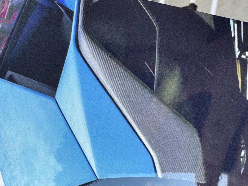

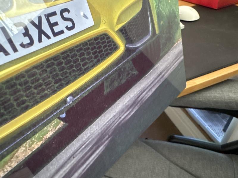

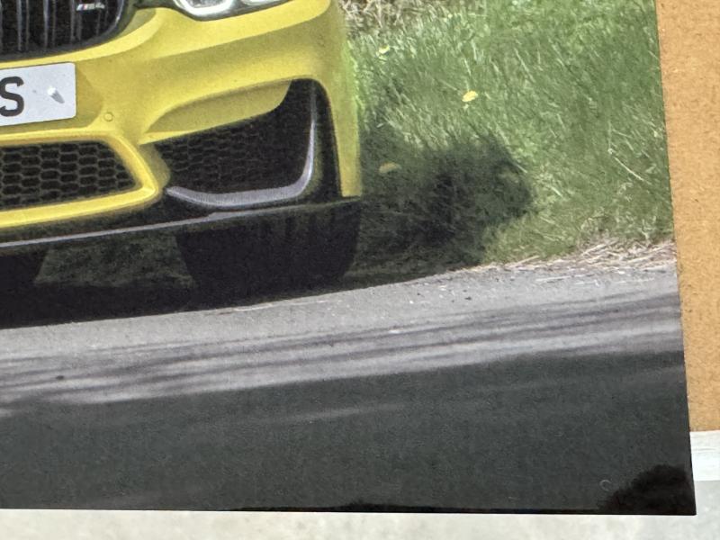

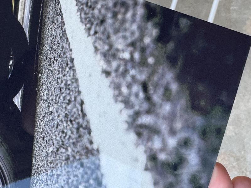

I'm trying to sort out some issues with my prints, i cant seem to get blacks and darker colours to print properly they all seem to come out mottled/greeny/yellowy? see pictures below of some prints I've done. its really hard to get a picture of what I'm experiencing.

Hi Alex! Your issue likely stems from mismatched ICC profiles or incorrect paper/ink settings. Even with Epson ink, using the right ICC for your transfer paper is crucial. Try sourcing profiles from the paper supplier. Also, ensure your color mode stays in RGB (sRGB) for best sublimation results.
