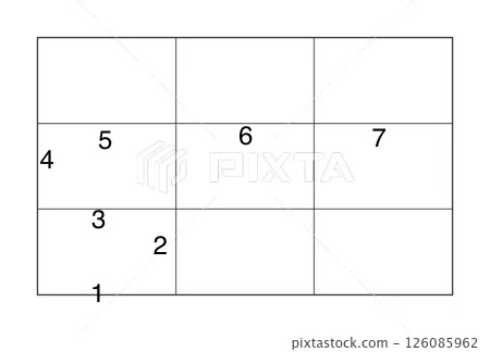

My mate Claude said----That cut order (1→2→3→4→5→6→7 as shown) is the classic "path optimisation" doing its own thing - the cutter is just jumping to whichever path end is nearest at each step.
**To fix it, reorder your paths in Illustrator's Layers panel to this sequence:**
The most efficient order for a 3x3 grid is to cut all the way across in rows or down in columns without backtracking:
- Outer rectangle first
- Top horizontal line (full width)
- Bottom horizontal line (full width)
- Left vertical line (full height)
- Right vertical line (full height)
That way the blade travels logically and lifts as few times as possible.
**To reorder in the Layers panel:**
Open the Layers panel (Window > Layers), expand your CutContour layer, then just drag the paths into the order you want top to bottom. The cutter reads them in that sequence.
**But the faster fix** is in your cutter software - look for an option to **disable path optimisation** or set cut order to **"as drawn"** or **"document order"**. That forces it to respect your Illustrator stacking order exactly rather than recalculating its own route.
What software is pushing the job to the cutter - is it Flexi, Onyx, or something else? That'll help pinpoint exactly where the setting is.

I gave up and re-made the file.
I created a new box then four lines selected all lines and named them all CutContour.
I put the box at the top of the layers and named the rest H TOP, H LOW, L VERT, R VERT.
Tested and it's only bloody cut it in order and working perfectly.
I have no idea what happened before but it's working now lol.
