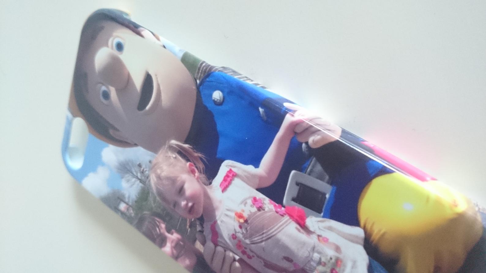

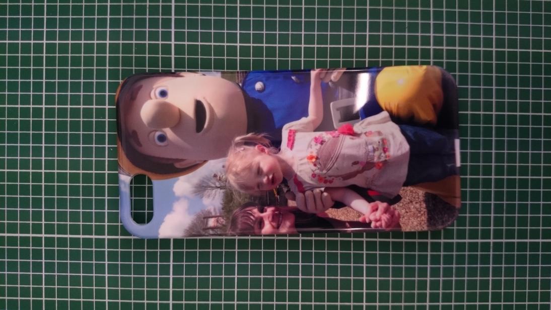

I have one but have only printed phone cases. It took some time to get the right time & temp (as it is nothing like the manufacturer suggested) but the results in the end are pretty good.
Here's an example.
vB_ID:2564
vB_ID:2564
vB_ID:2563
vB_ID:2563
Iphone 5 example1.jpg (91.74 KiB) Viewed 1122 times
