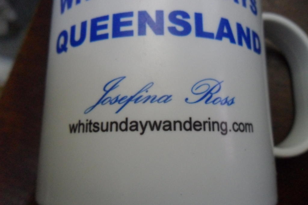

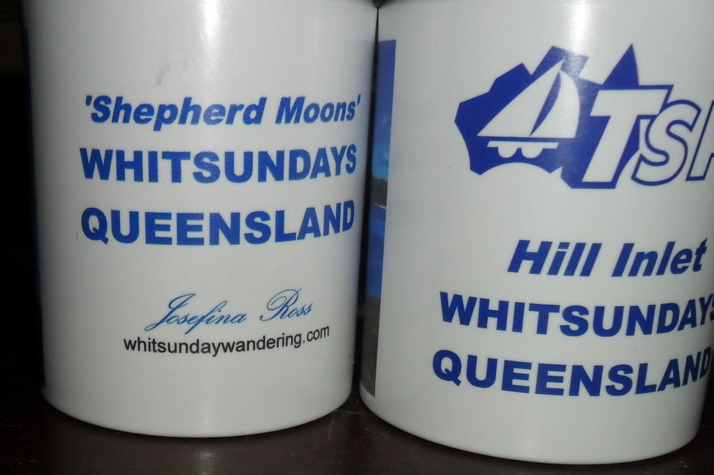

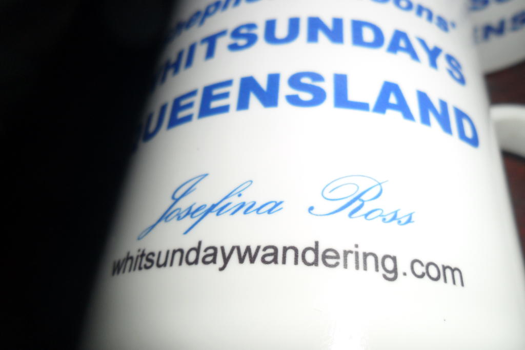

But my small black and solid blues are ok I think. I use a cheap Chinese press for the polymer mugs. The ones you see all over ebay with the horizontal heating element and the handle like the handle of a garden spade. I use the cheap Chinese mugs because we didn;t have a distributor with stocks of poly mugs in this country when I started doing them.
I can;t help with the Adkins
But for what its worth this is from the cheapo press. The Adkins will have completely different settings.
So what I've given you is my settings for Ceramic and Polymer on the off chance you might find a similar difference between the two on the Adkins.
I can say however that the settings on the instruction sheet forthe press were way, way off and I ruined a heap of mugs trying to press to them.
My press has settings for a a Dwell temperature, a Temperature to Press at, and a Timer. It is in FAHRENHEIT.
My Ceramic mugs are pressed at: Dwell - 230 Press - 345 Time - 140
The mugs in the pics were pressed at: Dwell - 300 deg Press - 330 deg Time - 120 sec
The thing that took me longest to work out was ghosting images. IU ended up using a much lighter pressure than I stared with.
Before pressing there is 15mm of the puck sticking out the top of the mug
The mug will deform a little, due to heat and pressure.
After pressing, and once the mug is COLD, if I slip the puck in, using its own weight to slide in until it stops, there is 34mm between the top of the mug and the end of the puck.
I hope that makes sense. I can't think of any other way to gauge the amount of pressure. It might give you some ideas to play with.
The images are not as good as I hoped. Zooming in with a cheap camera
But the edges of the text in reality are pretty crisp. The blue has no fading and is consistent across the whole text. The black is 'very' black.
