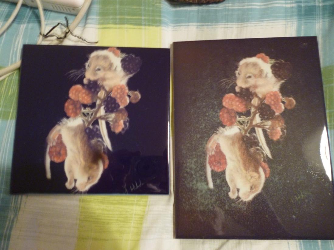

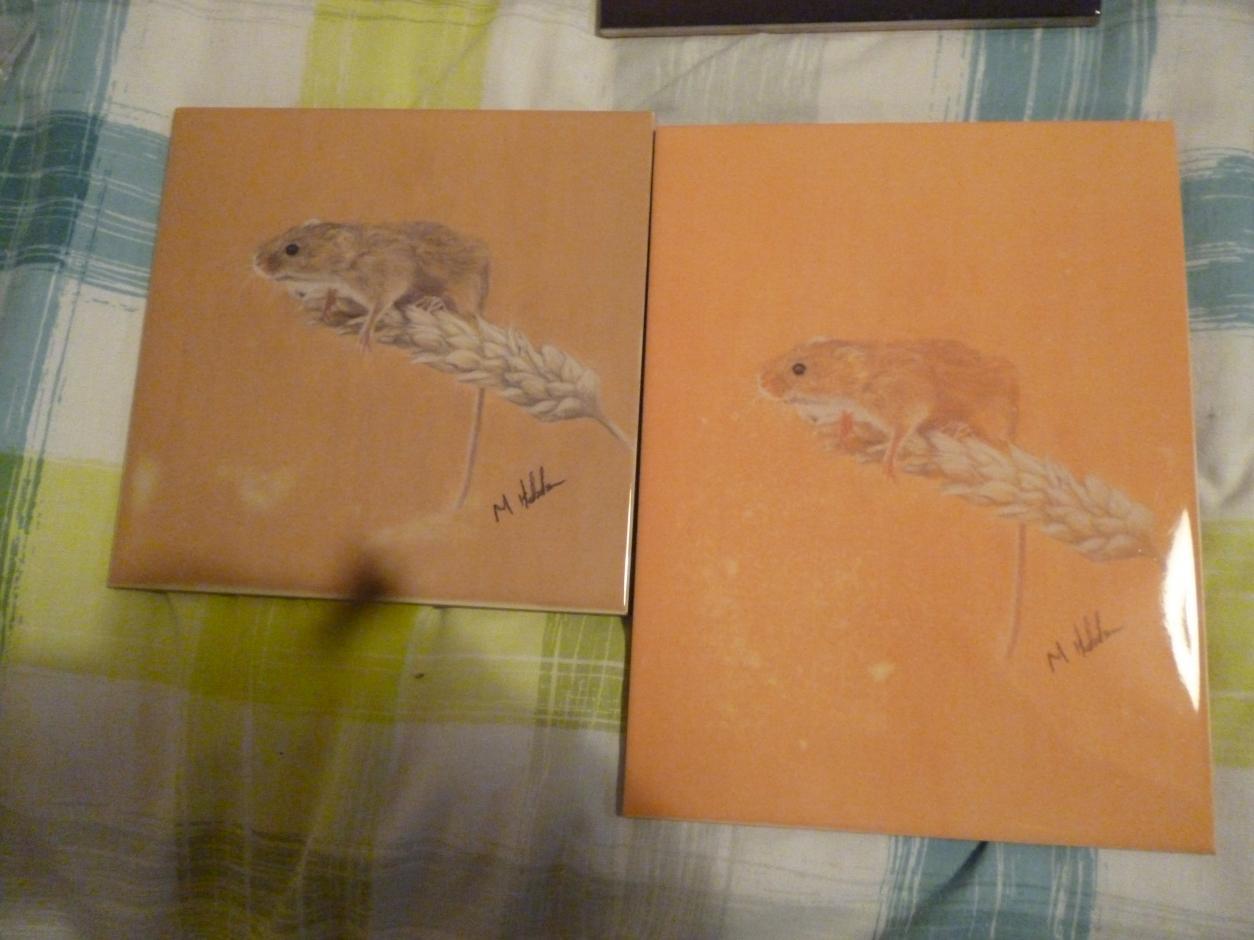

Here are a couple of images to show what I am on about, The 6x6 tiles look good with rich colours however the 6x8 are really poor as mentioned earlier.
again I'd appreciate any feedback from forum members....
John
John

Re: Issues with Ceramic Tiles
Hi Justin
Just posted a couple of pics. as you can see the 6x6 look great.
In answer to your questions. I am using PD in Photoshop as I had some great help from Sawgrass during the initial set up.
Secondly I am not preheating the tiles.
and yes bot sizes of tiles were from the same supplier (BMS) searching through the net there seems to be only them and Novachrome supplying these size tiles in the UK. I have looked into Tiles quite deeply and would like to try the products from Bison in the USA but can not find a UK or EU stockist, so if any one knows of other suppliers and can recommend them for quality tiles then please let me know.
Many thanks again
John
Many thanks again
John
Well looks like we've found the root cause with these 6x8 tiles at last.
I have been in constant contact with Scott at BMS who supplied the tiles and it looks like the problem is overspray in the tile coating, so a new batch should arrive and I'll let you know the outcome. In the meantime I would just like to say a huge thank you to BMS for their support, patience and understanding with this issue and I look forward to using them as my supplier for future products.
again thanks to the forum members for their advice also
Cheers
John
