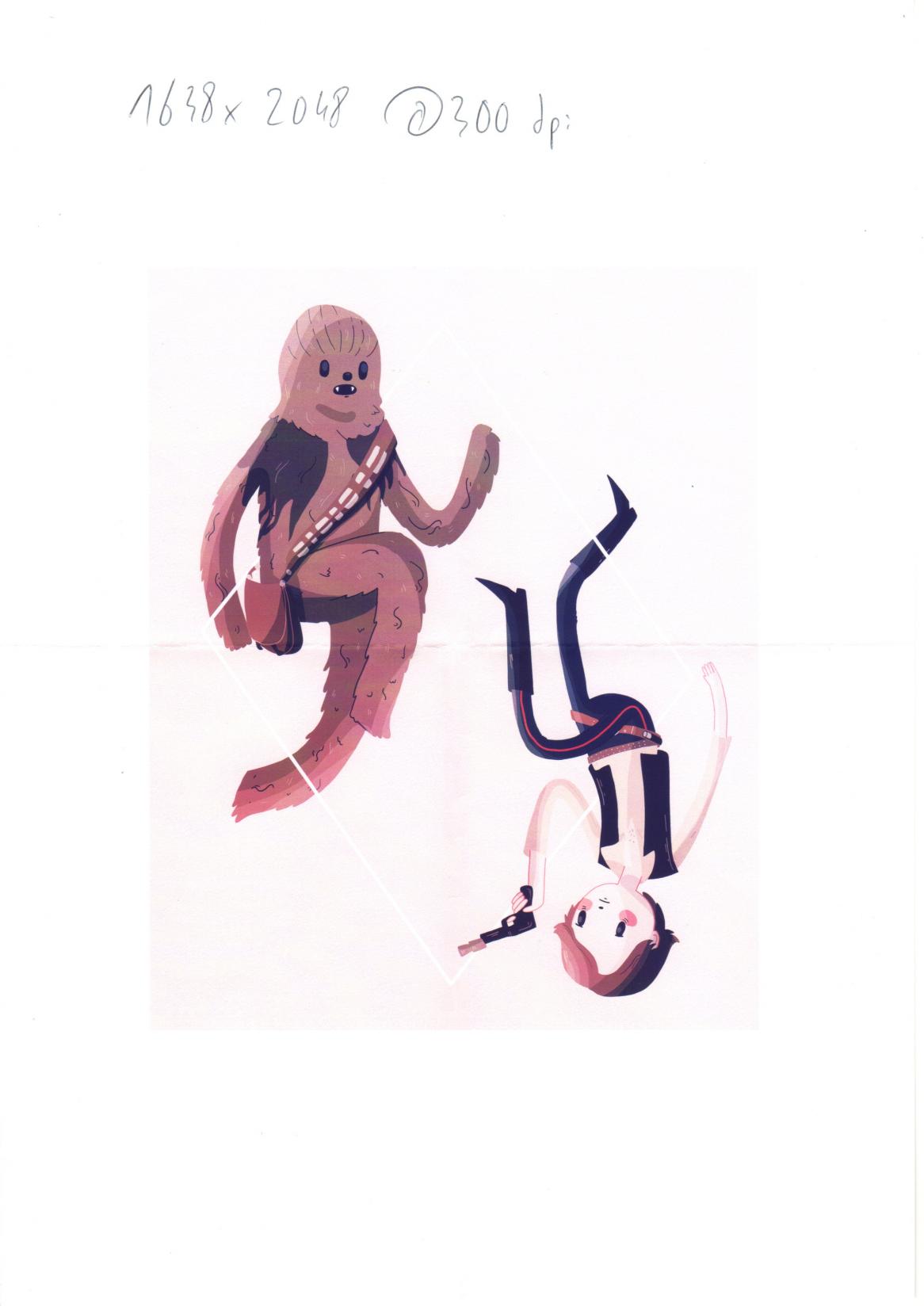

Ok I scanned a print I made today. When you look closely (you need to zoom to 100%), there are small black dots on the white/pink.

Press the paper with no image, do you still get the marks? If you do you have a batch of contaminated paper.

Problem is not when pressing, it's when I print, and it's not related to the paper as I tried another one and same issue.

malkram, you mean the square around the picture (looks a little pinky) ?
That's not there on this one....

I'm not talking about the square. In fact the defects can be better seen when you got the print in front of your eyes. Hey I see you have a 3110, it's almost the same as SG 400, could you print my image if I send it to you and send me a pic ? @scotty44

I think I'm having the same problem as you malkram. I'm using the same printer, inks and paper as yourself. I've also used two different sg400 and they both printed little speckles on lighter colours. It's not as noticeable when you print it out (but definitely there) but when you heat press it pops out more.

Also to add, it's not the paper that's causing the problem. I've tried truepix and xpres paper and both have the same problem.
