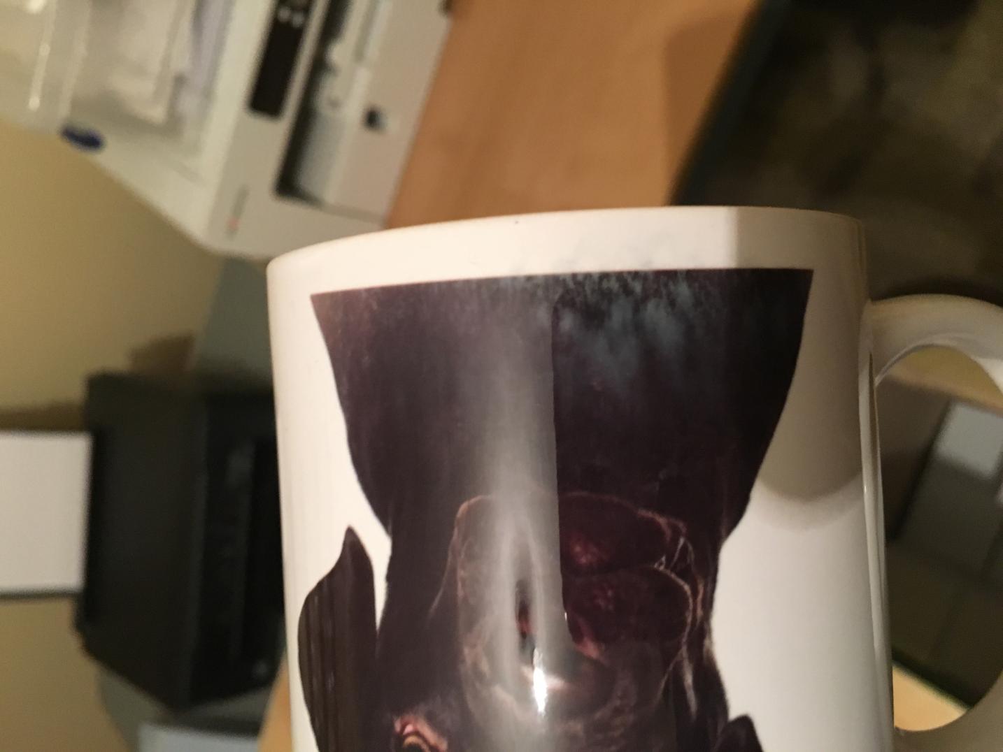

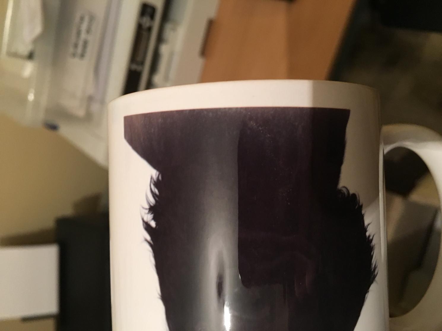

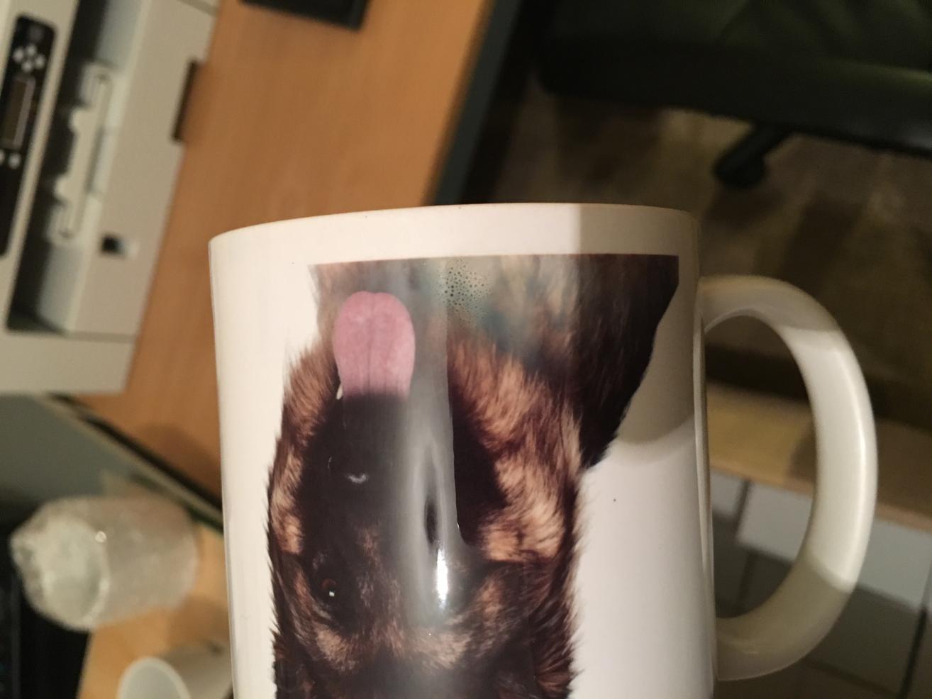

We have a mug press we bought off ebay from Coralgraph before Xmas which we use with a Sawgrass SG800 printer and truepix mug wraps. Our biggest problem is the bottom edge of the mugs some times they come out brilliant others they are slightly faded or like the attached images. We do them at 180 for 180 and have tried preheating the mug bottoms and fiddling with the tightness (so much so we smashed a mug the other day) we have tried A rated mugs from BMS and others from a local supplier who said the have the best coating. We where wondering about getting a 3d vacuum oven to see if we could get better edge to edge printing but after reading views on here I can't see anyone saying good things about them. Are we better off buying a better quality mug press if so what do people recommend I don't really want to keep making our images smaller along the bottom edge as think the gap already is plenty.

As a quick pointer, pre heat the bottom of your mugs for 20 seconds in the press before applying transfer and pressing. The base is thicker and needs a little more heat.
I prefer a small gap top and bottom rather than full top to bottom printing and you should achieve this quite easily with decent mugs.
