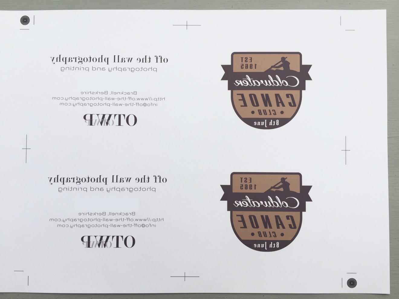

Just setup a Ricoh SG 3110DN with Sawgrass sublijet R inks, downloaded the driver, I am on a Mac. Setup Photoshop as per instructions. As far as I am aware I followed to the letter. I am using TexPrint-R paper.
Image is of a logo in black/brown(see pic)
I use crops on my print and they come out perfectly black! The blacks in my image however looks rather brown. before I go wasting mugs and garments, is this perfectly usual?

Press one and see. What you see on paper will not really have any correlation to colour post sublimation. Obviously temp, pressure and duration plays a factor.

Thanks UK Printed Mugs I did one with some previous setups with a similar print result and tried the 180/180 approach and got a reasonable result but a little muddy, blacks were not pure, the came out a little brown..
I have just ordered some mugs from Xpres and get my new Galaxy Mug Press next tuesday, I will try then!
Re: Worrying over nothing?
Brown could be over pressing. Too high a temperature for too long. Or it could be your printer calibration. Nothing beats custom ICC profile. We found SG PD4 to be rubbish!

Ricoh inks often print better at 160c, 160 seconds works for me.

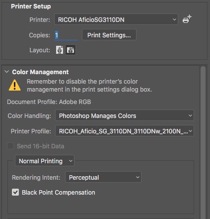

IS your black RGB 0,0,0 which RGB are you using sRGB or Adobe1998 ?
astrobutch
Posts: 13
Joined: 04 Aug 2016, 17:11
Post by astrobutch »
Thanks Mags, yes my black is zeroes and I am using Adobe RGB(1998)
mags1892
Post by mags1892 »
astrobutch;114532 wrote:Thanks Mags, yes my black is zeroes and I am using Adobe RGB(1998)
When you print also are you using Application manages colour and no colour management in the ricoh driver which is on inkjet plain paper?
sorry if im preaching to the converted but like to cross the t's
astrobutch
Posts: 13
No problems Mags! Good to be thorough..
