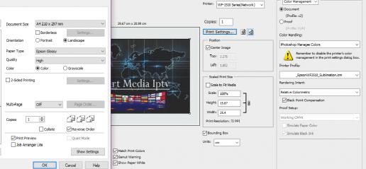

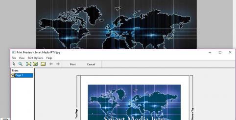

Hi,
I am having problems with my final image before printing ( Attached screenshots )
When I use custom ICC profile (Cityinks) the image changes purple/blue, when I change Printer Profile from ICC to Adobe RGB (keeping all other settings) it's perfect on print preview but prints very dark.
I have read on here Cityink ain't the best inks or there ICC profile service, can this be the problem?
Just to add paper from Natureinks & Epsom WF2510

Have you tried changing the rendering indent to perceptual. Try to ensure you use the same rendering indent you used to print the colour swatch for profiling.
Is your monitor calibrated correctly, what colour space are you using in photoshop, what settings are you using for soft proofing, are any of the colours out of gamut. Have you turned off colour correction in the printer settings, is the nozzle check ok.
City inks usually use a third party for their icc profiles, try contacting them and getting a second one done if the results are not as anticipated. Print the colour swatch on the paper you are going to use from natureinks.

OK open your image in photoshop as an rgb image (edit - assign profile - adobe rgb (1998)) and then select view - proof setup - custom and select your icc profile from the drop-down list with the correct rendering indent
Then select view - gamut warning the out of gamut colours will show as grey patches.
This should show a soft proof of the image with your profile applied.
I would really suggest you get the monitor calibrated as many people have it set too bright. I am not sure a television is going to give you the best results it would be preferable to use a monitor. Even the most basic monitor calibrator is better than nothing.
As a stopgap you could turn down the brightness of the screen to match the printout and then adjust the brightness of the image to suit. But it will be a bit hit and miss.
