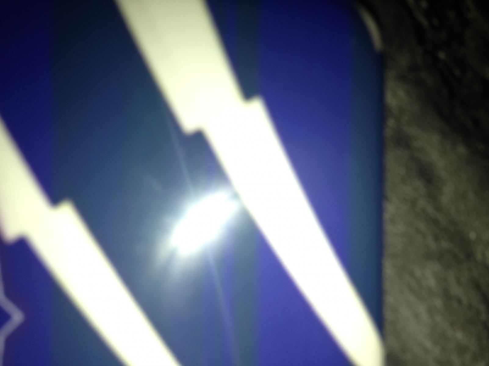

Can anyone shed any light as to why a pressed phone case would come out with strips going across its width??? It's hard to see in the pic but the stripes are kind of blue like I'm printing but kind of browny too. I'm trying to sublaminate an iPhone glossy case. It was in for 420 seconds at 190 in a mini 3D sublimation machine.

do a printer head test print you may have blocked jets
De8n
Posts: 26
Joined: 09 Oct 2016, 21:57
Re: Striped press
Post by De8n »
Would it show up on the print before I sublimate it as the print looked fine. And I only used the printer yesterday. Thanks for replying arfermo
ArferMo
Posts: 1061
Joined: 24 Jun 2014, 22:40
Re: Striped press
Post by ArferMo »
possibly not as you can often get away with several misfiring jets.
De8n
Posts: 26
Re: Striped press
Post by De8n »
Sorry arfermo, do you mean I wouldn't be able to tell on the print?? If so I'll run the cleaning thing tomorrow and retry.
ArferMo
Posts: 1061
Re: Striped press
Post by ArferMo »
do a head nozzle test print
