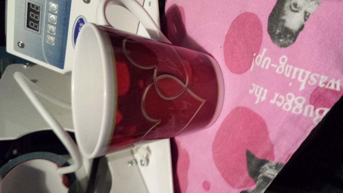

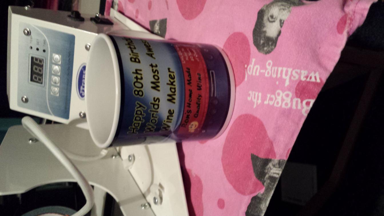

The OP said the press came from BMS not the mugs and the reason for the wrinkled paper is with a taper at the bottom of the mug the paper remains loose and the press wrinkles it.

Get in touch with BMS. Don't use that brand of mugs myself but there is definitely a barreling effect at the bottom. It is not a newbie issue as such as most would struggle to print those to the bottom. Even in an oven the paper would crease and leave marks although the colour would be regular all way down.
From what I have read on hear BMS mugs are supposed to be very good and that is certainly not a good mug. They should be able to help and clarify if it just the batch it came from.

That's actually obscenely wicked barreling at the bottom of that mug if you look at the second pic.
I stopped using BMS euro's last year due to shape issues. They went from fantastic to WTF? which is a great shame as the finish on them is awsome.

On a side note, the DF14 press is decent enough so I would eliminate that being the issue anyway.
Certainly a much better blanket than the cheaper mug presses. Still using ours as a second press with results as good as the Adkins, it's just a lot slower heating up.

Thank you to everybody for all your help i have taken on board all of the comments and advice given, to clarify the mugs are from BMS , i have had some success tonight by heating the bottom of the mugs and reducing the size of the wrap as suggested and they are coming out much better, i will keep on trying and i am sure it will come good soon , i have added a couple of more pictures for you to see the latest results Thanks!
