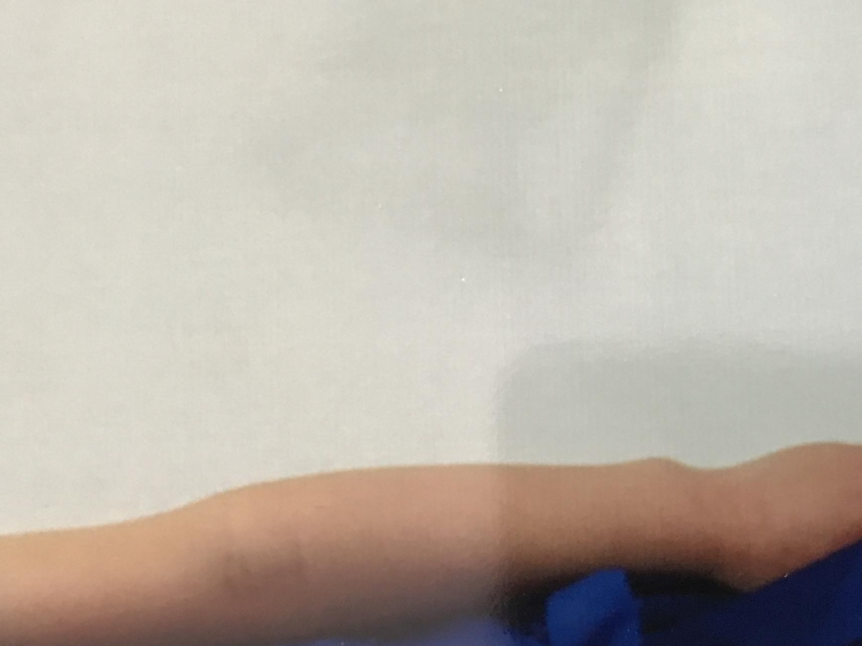

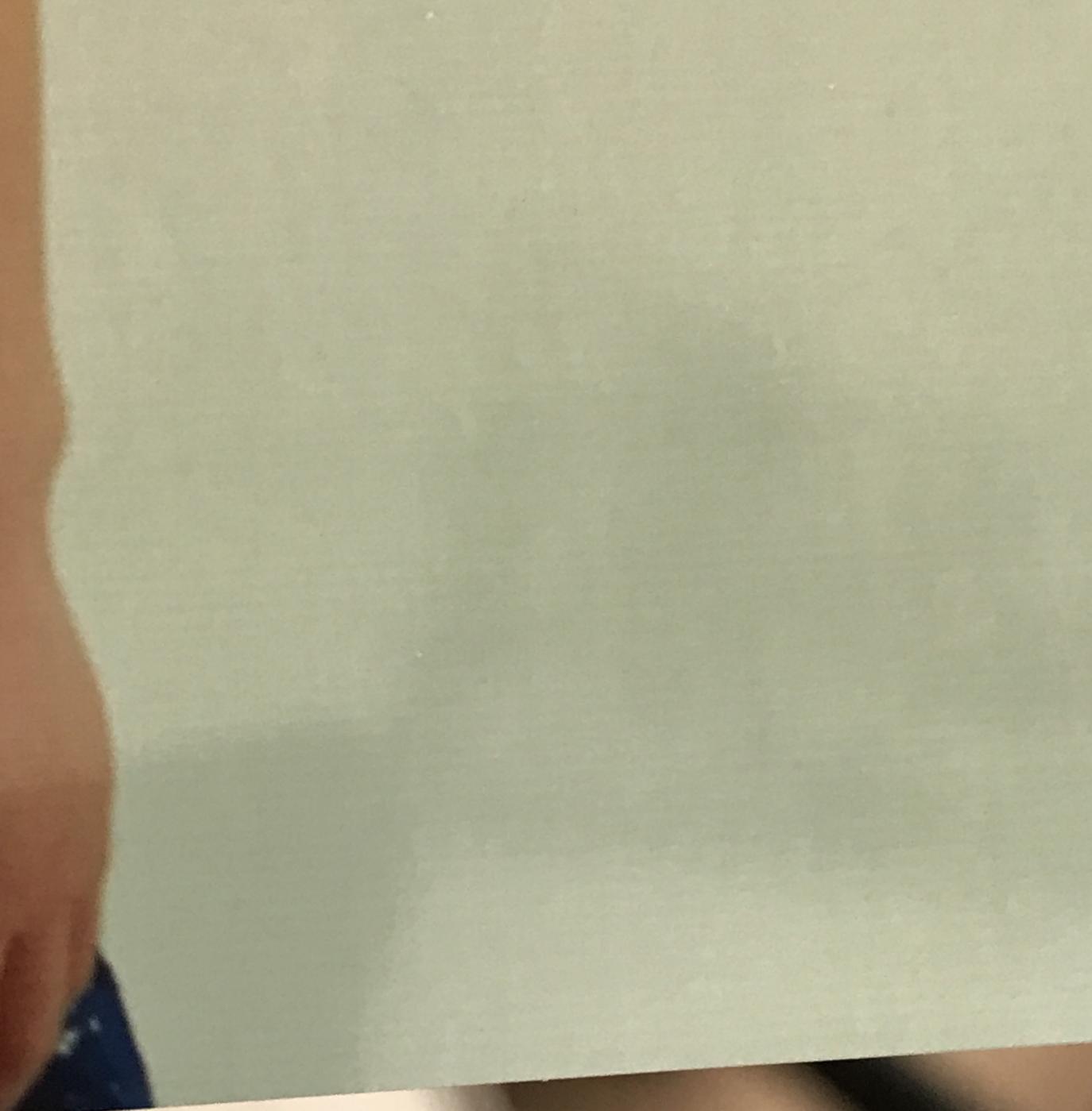

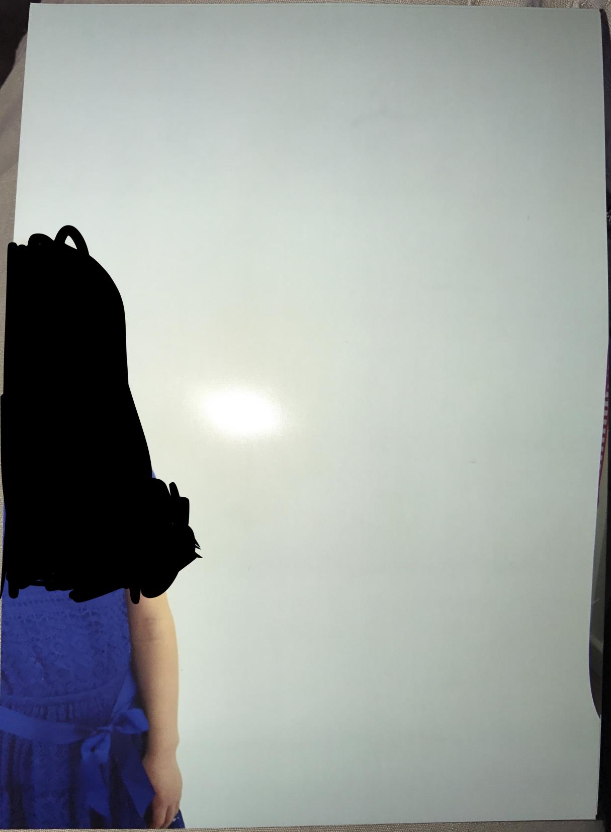

We picked up a brand new DNP DS620 a few days ago to use for onsite printing at various events. After printing a good few images out to test it, I've noticed some faint horizontal lines across the photos.
They are are very faint, and the wife believes I'm just being picky, so I thought I'd ask in here to see if it's something that shouldn't be happening, or if I'm just expecting too much from the machine.
The lines are visible when printing with a gloss finish, but not when printing in matte. Also, if I use high quality rather than high speed, the lines pretty much disappear. They're most obvious on solid blocks of colour, but can be seen over the entire picture.
I've posted a few images. The lines can't be seen in the full version, but I posted it so you can get an idea of the scale. I've blacked the girl out as she's not my daughter, but it was the best print I had to show the problem.
All input appreciated, even if it is to tell me to stop being so picky! :)

Could be a number of things....print head causing banding, media feed calibration not quite correct meaning the media is too fast/slow through the printer are the first I would look at. As for expecting too much? Look at the product from the customer's perspective.....if it is acceptable to sell then OK but honestly for me....no it's not. Banding makes a print look poor quality and won't do your reputation any good.
