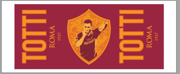

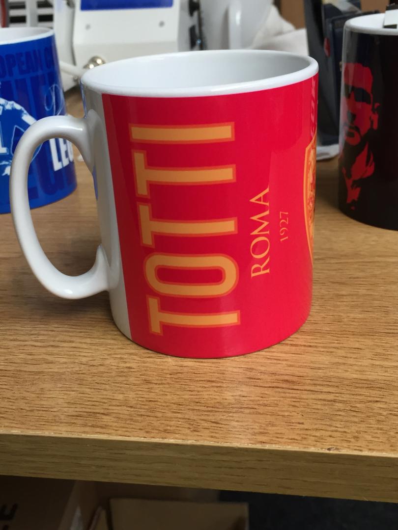

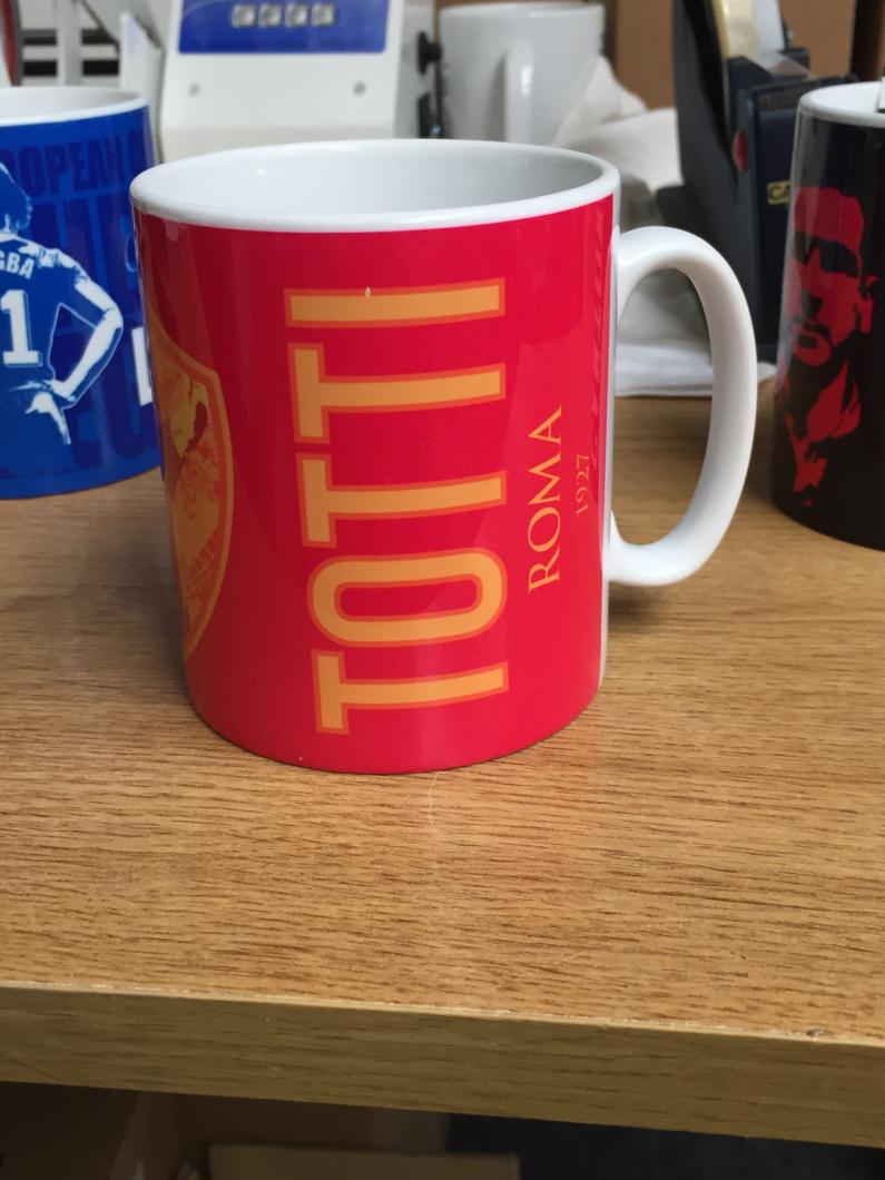

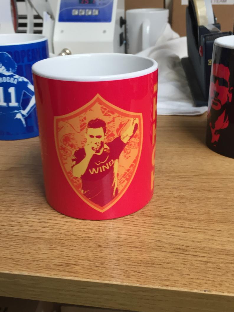

we have been using the ricoh sg 7100 dn for about a year been fine but we recently changed our mugs from 10oz coated ceramic mug ultra white to the 10oz Duraglaze sublimation mug but having problems with the colour profiles
vB_ID:4752
vB_ID:4752
as when i get the graphic with the colour i want on the screen such as
vB_ID:4752
vB_ID:4752
with the background as maroon it prints out on the mug as a finished product like so
vB_ID:4752
vB_ID:4752
vB_ID:4752
vB_ID:4752
vB_ID:4752
vB_ID:4752
as you can see it comes out more pink
any help appreciated
THanks
Luke

Doesn't look like you have the correct ICC profile selected. The one in your dialogue image is sRGB.
subside
Posts: 4
Joined: 04 Aug 2017, 10:27
Re: ricoh sg 7100dn colour change from on screen to finished product
Post by subside »
please excuse me im not very good with this i was just passed it over from the boss, where would i find the correct icc?
Have a look in the Printer Profile dropdown list and see if there is a profile in there that looks like it may have come from your ink supplier. If everything has worked fine before you changed mugs then I'm assuming you have the correct profile somewhere.
technick
Posts: 372
Joined: 23 Nov 2015, 21:50
Post by technick »
These are the correct settings only for Sublijet inks, if the inks are from elsewhere you will need a custom ICC profile.
Also try changing to Relative Colometric.
subside
Posts: 4
Post by subside »
yh i re-downloaded the drives and done the settings again to make sure there all correct and up to date.
il give that a go and update later
thanks for the advise
