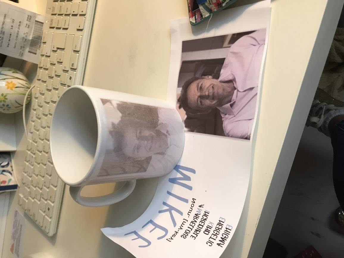

Hey folks
Newbie with his hand up.
I have a Galaxy Mug Press Pro
Ricoh 3110dn
Sawgrass sublijet r ink (this is first ink installed)
Powerdriver v4 installed
Dino Coating DyeSup Paper
Dyno coated Subli blank mugs
I believe I was all set up but when I press the mug at 185 c for 160 seconds the print on the mug is so feint. Had three attempts but still the same result.
Any obvious errors or pointers for a man in distress
Thanks in advance folks :-)

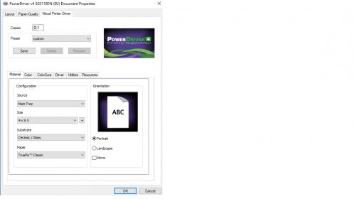

I'm assuming that the substrate setting is correct at Ceramic/Glass
and the paper setting is a mystery as the one I'm using is not in the drop-down. I've tried a couple but no change.
