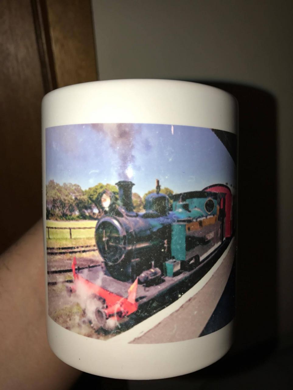

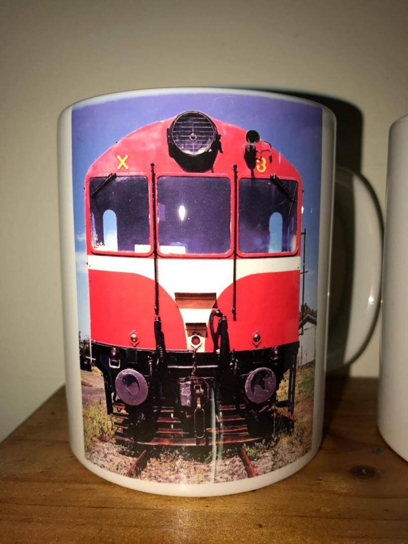

Hi all, it has been a lot of trial and heaps of error, from stuffing up colour management right down to sizing of the photos and dpi. Some things I have picked up along the way of stuff ups to huge hissy fits is this.
1: Always let the printer manage the colours and select the correct colour matching setting in PS.
2: Always put a bit more saturation in the image than what is needed just to compensate any issues with printing.
3: It is not always the paper or ink but it is sometimes the user being a noob.
4: Always allow your mug to warm up for 15 to 20 seconds before putting the transfer on it so you get the best out come after it has sublimated.
5: HOT MUGS ARE BLOODY HOT
I know better ink and paper will improve my prints but I am so excited to see where I came from a few weeks ago to where I am today. Thanks for all the help from this forum.
This was my first ever mug I made and trust me it looks worse in real life. This is a mug I did tonight, colours are stronger and the image is nice and somewhat sharp as it was taken on a mobile phone, this looks better in real life.

Your bullet (1) "Always let the printer manage the colours and select the correct colour matching setting in PS" is not regarded as correct and certainly not in the professional world of printing. You need to have a custom ICC profile made and therefore your printer should NOT make any decisions. It should be down to your software e.g. Photoshop for colour handling and using a profile.
Re: What have I learnt?
As this was a trial I didn't really want to spend $600 on a custom ICC for inks that cost me AUD$40 for all 4 colours, I have spent a lot of time playing around with settings between PS and the printer and I found the best result I get for the ink I have is to let the printer manage it with no colour correction added to it in the print box. Sorry if I offended you.UK Printed Mugs;125361 wrote:Your bullet (1) "Always let the printer manage the colours and select the correct colour matching setting in PS" is not regarded as correct and certainly not in the professional world of printing. You need to have a custom ICC profile made and therefore your printer should NOT make any decisions. It should be down to your software e.g. Photoshop for colour handling and using a profile.
