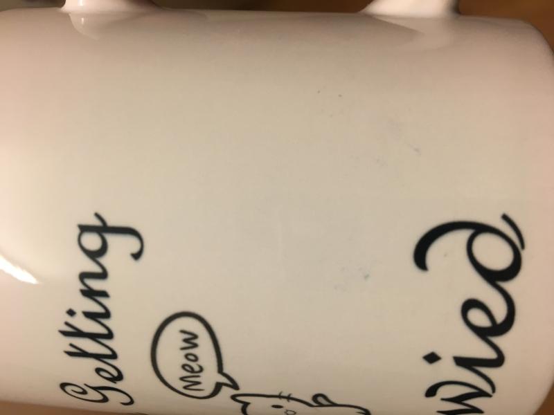

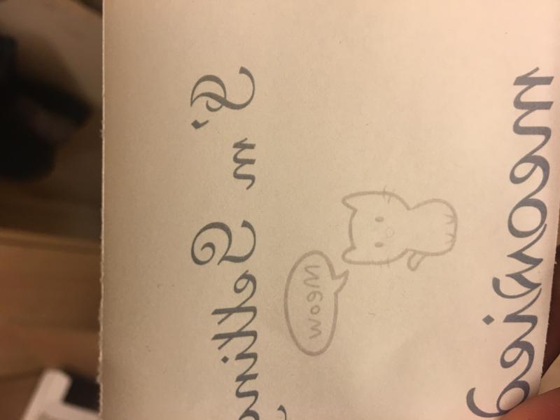

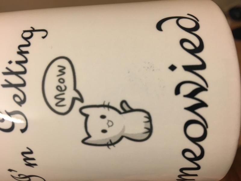

Hi Everyone,
since last couple of days I am getting inks on mugs after sublimation. I didnt change anything like paper, ink, printer or mug press. After printing i am waiting for ink to dry on paper. Any idea you guy suggest me ?

What mugs and paper are you using?

Justin;126884 wrote:What mugs and paper are you using?
Thank you Justin for your reply.
I am using signworld mugs and cityinkexpress paper. Also ink from cityinkexpress.
I have also played with different temperature and time.
Regards,
Jay
Posts: 12090
Has thanked: 11 times
Re: Stray ink on Mug after Sublimation
Times and temps won't help, it's finding this ink from somewhere. if the ink isn't visible after printing it sounds like somethings happening during the print process.
I would advise you try a better paper, Trupix for example. Also, I'd be looking at changing those mugs personally. that doesn't help much much for now.
What printer/inkset are you using? Is the additional ink definately not showing on the print? Are you allowing it to dry?

I have had this before, sometimes you just cannot see it on the print. It went after a while, I believe, for me anyway, it was ink that had dropped onto the rollers, and as I said even though I looked at the print couldn't see it.
Are you sure you have the mug clamped up tight to stop any ink leaking along??

Try a head clean, it may be a fine mist that you cannot see on the paper.

James990;126887 wrote:I have had this before, sometimes you just cannot see it on the print. It went after a while, I believe, for me anyway, it was ink that had dropped onto the rollers, and as I said even though I looked at the print couldn't see it.
Thank you james for your reply.
I am using pneumatic mug press and all look okay to me.
I am getting on some mugs not on all mugs.

John G;126888 wrote:Try a head clean, it may be a fine mist that you cannot see on the paper.
Thank you john.
Yes I tried that many times but no luck [emoji17]

Justin;126886 wrote:Times and temps won't help, it's finding this ink from somewhere. if the ink isn't visible after printing it sounds like somethings happening during the print process.
Thank you Justin. I will try on durham orca coated mug and with new paper which i order from ink express.
I am using ricoh printer 3110dn. Ink from cityinkexpress. Yes i am allowing atleast 10 minutes to dry.
