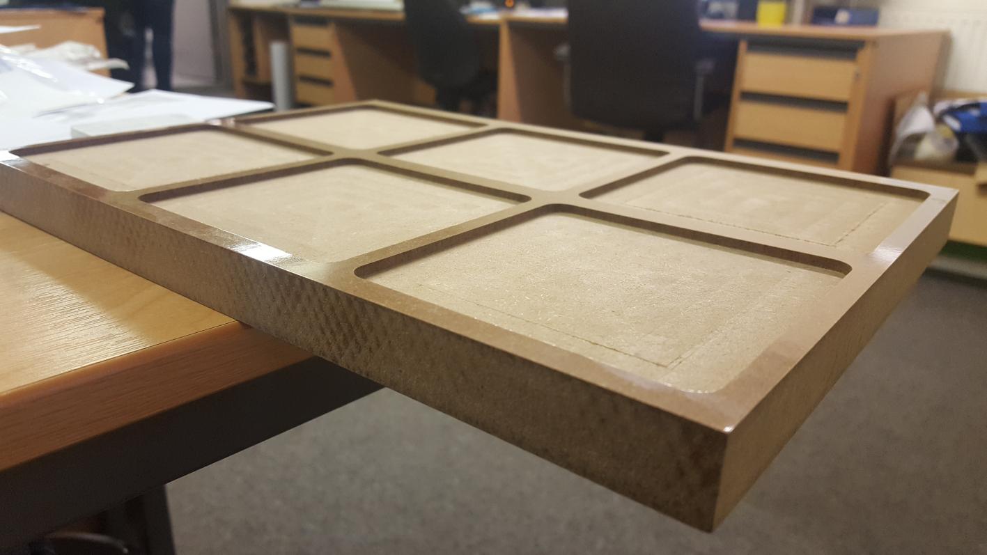

So I have tried the Jig from xpres, its too thick, made of mdf and provides very poor results. Fading in different places each time have killed about 80 coasters so I have given up. I would definitely be up for developing and custom jig.
The MDF one is really thick, I guess to prevent warping over time but it seems to absorb heat at different rates maybe. That's the only explanation I can come up with at the moment.
Looking at the picture someone uploaded (I should check back on who but I've had a couple of drinks tonight and cant be bothered) I would say that looks good but could maybe benefit from a couple of extra holes at the sides to allow fingers to get a grip of the coaster and remove it easier.
In essence, If we got 10 or so people interested I think we could get these made relatively cheap. I don't mind funding it tbh as I guess I could flog them on ebay afterwards to get back some of the costs. Would just take some hassle in the first place to get sorted. It seems it would fix the backing issue, and make larger runs much more cost efficient.

New coaster jig ready to trial.

Andrew;129015 wrote:New coaster jig ready to trial.
Have you done any test prints using the Jig yet? :)
