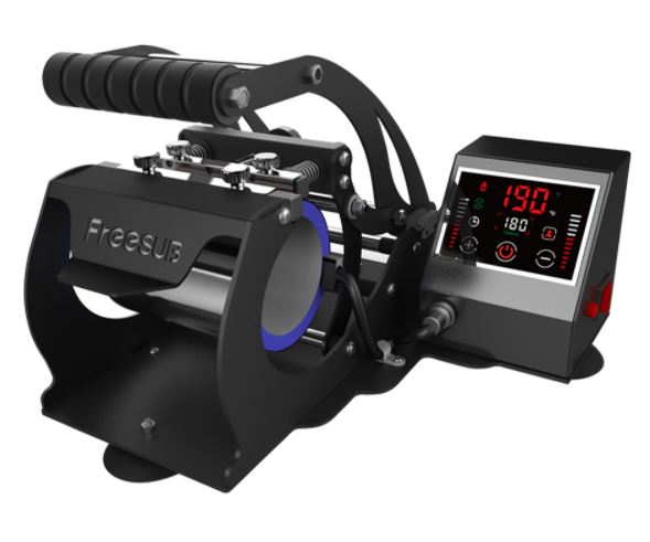

Hi, peoples, had my Mug press arrive from china on Friday is there anything I should be aware of is there any way of testing the actual temps.
Its a freesub with the touch LCD see attachment, not sure if its any good but I guess I will find out lol, I do have access to the generic types but thought I would give this a go first well because it looked pretty lol no much info out there on them.
Its supposed to be white grey its closer to a green though lol probably radioactive paint on it.
Thanks Sean
Thanks Sean

There is not really a way of testing the temp of the element (apart from perhaps using an infrared thermometer that would normally be used to measure brake disc temps on cars / trucks)
For standard 11oz sublimation mugs I usually advise to set the press temp to 175c (they fluctuate +/-5c when pressing so 175c is a safe bet) set time to 180 seconds.
