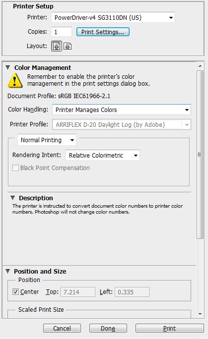

These are my setting, all colours print correctly

I have changed the settings to 'Photoshop manages colors', but the result is the same.
If I try the power driver, the printer does not print at all ... so I have to look into that.
Re: Red is orange after press
Workspace should be Adobe RGB 1998, not sRGB
Photoshop manages colours, and select your sub ink icc
use normal printer driver, not power driver
turn off all colour correction etc in printer driver

I know it's not the perfect sollution, but I played a bit with the onscreen colors and now it works for me ... however, I would like a permanent sollution for this problem. With all the tips you gave me, not one of them was the tip to help solve it. So I will keep on searching!!!
