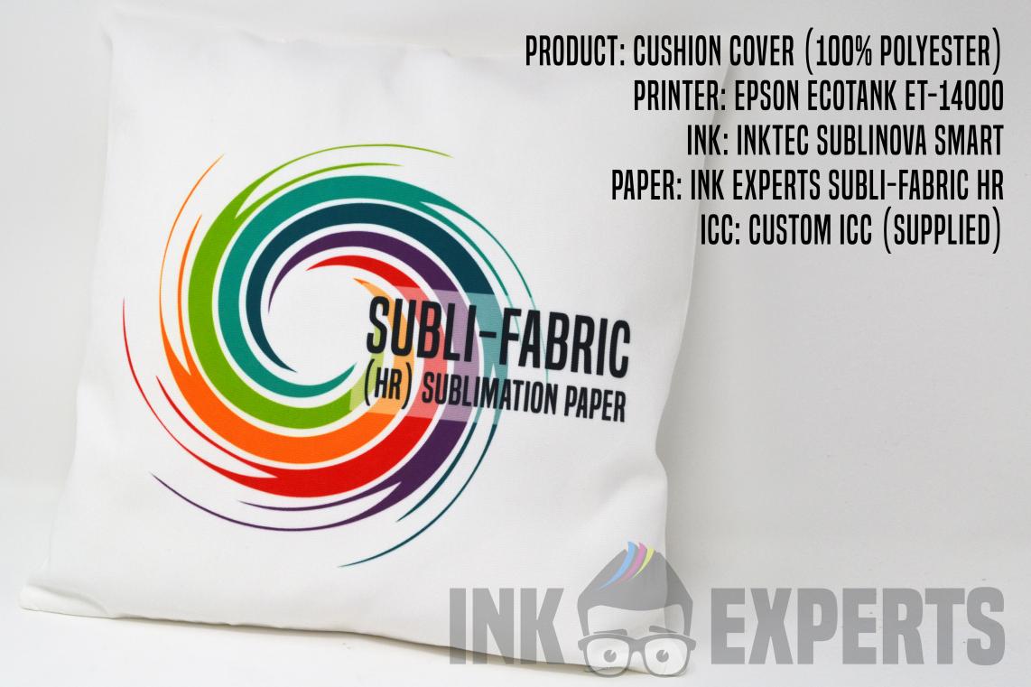

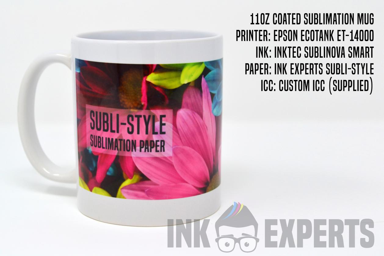

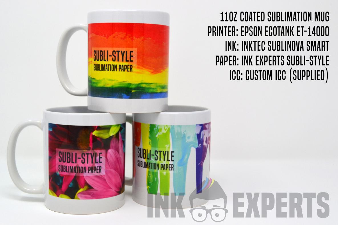

On hard surfaces the picture quality is sharp and vibrant.
Lines are held well and there is a high level of detail in photographs.
With fabrics we found colours to be bright and vivid.
Again, lines are sharp and detail is high, though some aspects of the image are lost due to the porous nature of fabrics.

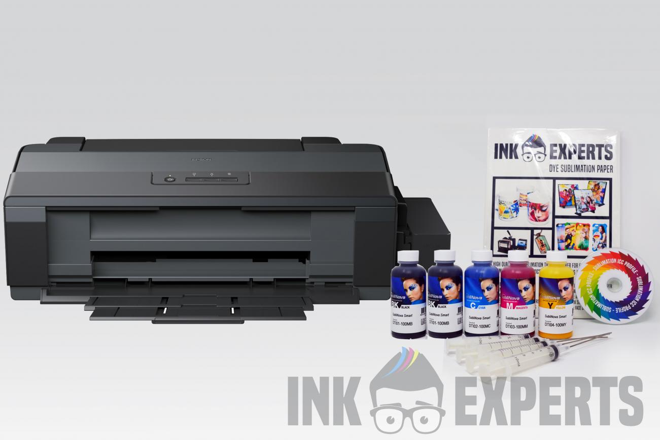

As A3 printers go we considered the Epson 1500W to be the best for quality and affordability.
Nothing has filled that gap and the cost of A3 printers has risen considerably.
In steps the ET-14000.
Based on the 1500W, the main difference is the ET-14000 has 4 colours in its 5 ink channels (C,M,Y,K) rather than 6.
The price has also increased, but with the added benefit of an Ecotank we find this increase to be justifiable.
Colour quality matches that of any other 4 colour Epson printer, but the amount of detail in prints appears to be better.
