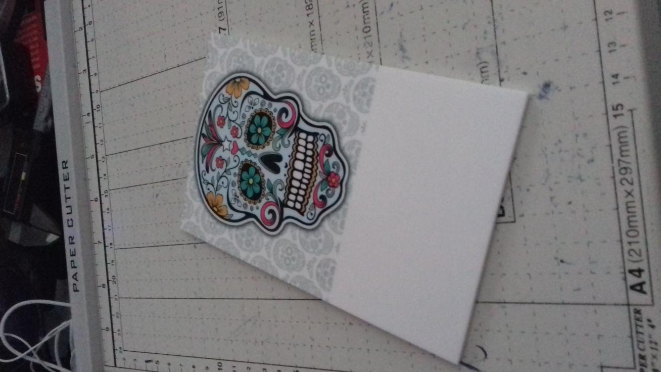

Here's a sugar skull image I sub-printed on 2mm acrylic as an experiment...
[ATTACH=CONFIG]5906[/ATTACH]
Temp: 190 C Time: 60 secs Pressure: medium.

No, just the usual soft pad on the bottom platen of my press, a sheet of copy paper, the acrylic, the transfer, then another sheet of copy paper, or baking paper. I don't use teflon with acrylic as the texture of the teflon sheet transfers to the acrylic when hot.Whitecar;139852 wrote:Thank you for the info.
